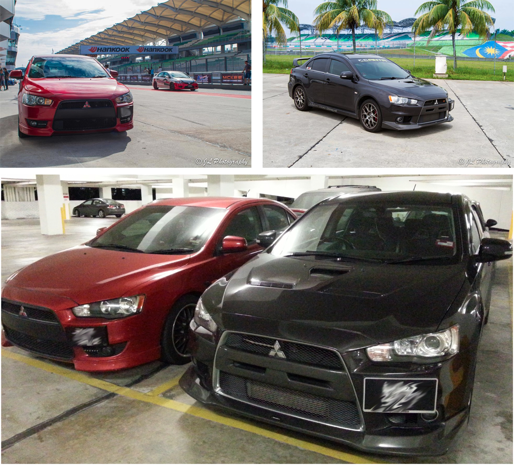

I have both Turbo Variant and Non Turbo Variant of the same Lancer model (Yeah.. am nuts)
Yes, I do realized the EVO is so much hotter than the standard Lancer.
However, like Halycon mentioned, Turbo usually kicks in at higher RPM, so if you are caught in a jam in the beginning of your journey.. the engine bay will not be super hot yet, comparing you to Boost boost your way into the Jam.
And... Most cars will have thermostat factory installed, so if you are in a jam and the engine bay gets hot, the fan will be activated and blowing at top speed (even if you turn off your engine before it cools down)
Also don't forget, the turbine is harnessing all the exhaust along with it's heat and with no factory heatshield on them, it will be radiating the heat into the engine bay... For cars with stock turbo, usually there are vents or dedicated air flows designed to channel the air away or to cool it down (especially Evos)... If it is a aftermarket turbos, a custom vent have to be made.
Lastly, for Turbocharged cars, always monitor all the cooling components... Engine Oil must be changed when it's time to help protection and lower down friction/heat, Coolant, flush them if shows any signs of rust and give your engine a good engine wash if its filled with dirt or oil smudges... It does help...

You are owning CZ4A Evolution X and Lancer GT?

:top: Then this is an achievement, not nuts.
But to many normal people out there, they will think that you are actually owning 2 identical cars. I've seen a lot of people telling me Lancer GT is Lancer Evolution. At the end, I need to explain to them that the 2 cars are very different cars even though they look similar outside. Example, I told them they have different engine, chassis, brake system, suspension, seats, front lights, wider fender, exhaust system and etc. But many of them still looked confused and blur after the explanation though. :banghead:
Thank You!
I tell you what is :banghead:
Many thought I owned an Inspira... with body kits...
And yes... some people also mentioned to me that Lancer Evo X is very common as it's all over the place.. :idea:
