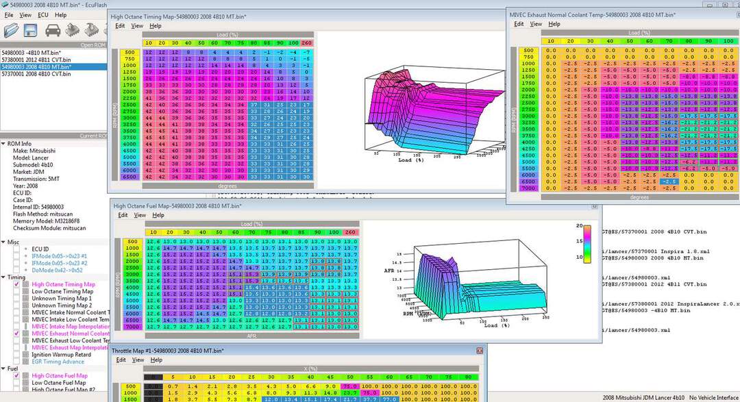

go get some contact in the inspira club.. i knew inspira/lancer ECU can be reflash.. there's one lancer/inspira specialist in pusat otomobil seksyen 15 there..

no need to install piggy back,lancergt/inspira stock ecu can be reflash by using open port 2.0 tactrix cable to remove speed cut/rev cut and most importantly alter the fuel and ignition mapping/mivec etc. Stock ecu run very rich.I manage to pull some rom file from stock ecu.running very rich ~ 11 ~ 10.5 at higher rev,if target 12 should unleash more hp/torque

no need to install piggy back,lancergt/inspira stock ecu can be reflash by using open port 2.0 tactrix cable to remove speed cut/rev cut and most importantly alter the fuel and ignition mapping/mivec point etc. Stock ecu run very rich.I manage to pull some rom file from stock ecu.running very rich ~ 11 ~ 10.5 at higher rev,if target 12 should unleash more hp/torque
