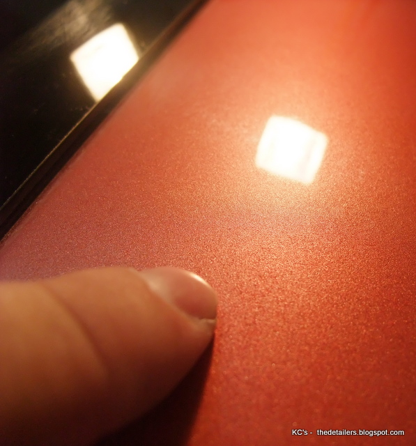

10 years single coated paint -
heavily oxidized, lacks of defination & clarity..soon turning to matt finish..
how we corrected the paint & coated with OPTI coating

simple explanation
after years of oxidation, and contamination that does not immediately removed, causes this paint so rough & charred
seeing the severity of it we decided collaboratively to cut away the rough paint by OHSC at 1500 speed
followed by leveling the paint by OHSP with at 900 rpm & finishes with 600 rpm
the key of a perfect finish is "keeping your polish pad flat"
how one can turn this
to this
checkout the newly painted hood (permanently protected by OPTI COAT)

simple explanation
