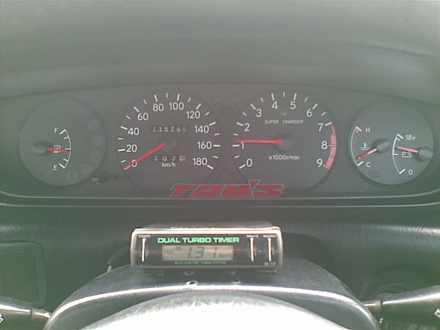

was trying out my car on drag strip today boosting only at 1.1bar. Found out that there is a leak somewhere near the charger. causing the charger to open only at 0.10 bar. i have to jack up and check where is the leak.
before this, im boosting at 1.3bar. NOTE: for SC14 players, pls change gears at 6.5k, if you want your charger to have a long life. Dont risk by melting it.
Im still using stock IC. Will try to use FMIC from VR4 soon. See if there is any increase in boost and also any lag.

update! today i did some tuning and my boost is 1.40 bar. :thefinger:
Bump: update! today i did some tuning and my boost is 1.40 bar. :thefinger:
that is coming from SC14.
never dyno it. gonna do some additional mods before going to dyno.
gonna upgrade TB taken from 3S.
