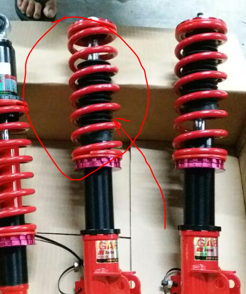

oh I didn't explain bumpstop. When lowered the springs are presumably lower so if your absorber isn't short stroke then the travel will be kinda long. Without a bumpstop it'll keep travelling until past it's lowest point which then means metal to metal knocking and general discomfort and ugly noises.

Owh yeah, that true, i did some research for the bumpstop, i dont think my gab he series have that.. picture of the sus im using for your reference

Underneath the black cover thingy (dust cover?) the bumpstop is underneath usually. But doesn't look like it's there.
