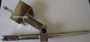

if install short shifter or quick shift.. dun need to change gearbox ler... it's just some modification to the gear lever shaft... see attached pic lor... market price for ready made (aftermarket) now only ard RM100-150 only.. cheap cheap... if u wan.. i can source for u too. It is used so that the distance to shift between gears are shorten at the lever there... not in the gearbox itself.. it's like when u change gear on steriods.. hehehe.
Imagine this.. u need to walk from point A to B distance 3KM.. after upgrade to short shifter the distance from point A to B now is now reduced to 2KM.. would u reach point A to point B faster coz of the shorter distance u need to travel?
Correct Installation will actually helps in faster shifting.. otherwise.. u'll start cursing.
