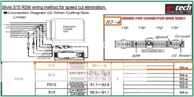

I WISH TO ASK MY SILVIA S15 JUST INSTALL A RSM,STARTING WAS OK,BUT THINK AROUND 5 MINUTE THE REV WAS NOT FUNCTIONING(RSM) TOGETHER V MY METER RPM ALSO NO SIGNAL...
I INSTALL FOLLOW BY THE WIRING DIAGRAM FROM INTERNET......

The correct way...
Pls re-check if it wasn't u that fix it.... TQ

thanks for ur times bro....yes i using above diagram..its work when starting install(around 5 minute)...afterthat i install to push start button than i realise the rpm both not working,,....(*meter and rsm)..
and i check back to conection found that one of the wire was lose from conector(conector long wire rsm)i suspect the wire shot to beside wire and i check the fuse box one by one nothing was burn..???and i use computer to conect they got signal rpm from ecu..... push start button will cause to its???and i try to remove the wire from push start botton to original back till the same!!!!headache o... no idea liao.. the only thing i havent check is meter wire....

Okay... now I understand more clearly your problem.
Now the important point is... which wire loose from connector? 12V(red) or RPM..
If 12v touch the rpm wire... yes can short out the dash rom meter...
Start button should not have relation.. unless pull pull the wire lor then kena the rsm...
If u confirm ecu rpm still got signal out by dianogistic cable/socket... then dash meter maybe koyak.

You want to test?... cut the rpm signal wire into 2, then join the rsm to the ecu side wire...
the other side wire... just tape up first..
see if rsm-rpm can work onot. if can... ecu ok, rsm ok....dash rpm KO!
