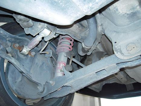

Has anyone tried converting their rear suspension from trailing arm to multi link? for proton wira? can it be done?

proton wira using macpherson struts for rear suspension assembly....
only saga iswara from proton variant using trailing arm multilink suspension...
quite impossible to do as u need to cut and mod ur rear arch chassis/frame structure.... all calculations must be precise so ur car wont crabwalk in the future....
not to mention, it is illegal under the laws of JPJ...
if u jz wanna improve ur car handling, better dont change the whole structure... jz use available aftermarket products... if u planning all out for drivetrain conversion (from FF to FR), keep us updated with ur progress...

I changed the 2 dog bone connecting to rear trailing arm, the bush, fto rear lower arm & 16mm antiroll bar, GAB HA series suspension. i reinforce the chassis. now car jumping like rabbit. hehe, just wondering if it would be better to mod rear system.

from my fren experience, fto arm wit arb itself will make handling better n harder, even wit stock suspension, done at sgti, wit adjustable suspension should be more harder...
