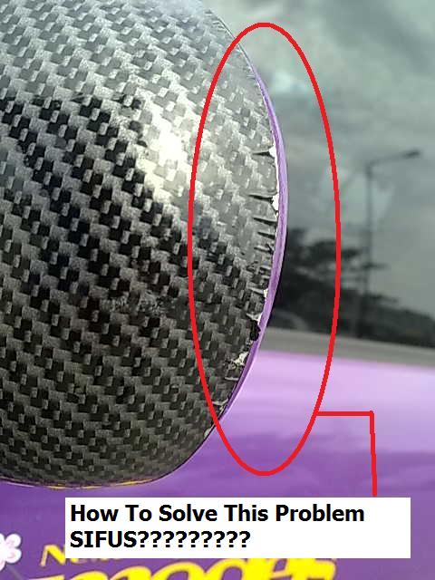

I'm new in using car sticker. I've attached a picture to show the problem I faced when sticking car sticker. Pls any SIFUS can help me...Thanks

Thanks for replying, for your information, i 've already used the method you two mentioned.
but the problem is let say i paste the carbon fibre today and it is very fit, but it will become bend as shown in figure after overnight or expose to sunlight, what should i do? helpppppppppppppppppppppppppppppppppppppppppppppppp

Thanks 1st. i knew your point, i also don't have any problem in pasting carbon fibre on the bonnet, the point is when it comes to a curve surface and corner angle, for example the corner of side mirror, then the problem mentioned will occur. specially when pass overnight or heat by sun. any clue?

From the picture...
You only did it on the outside and the egdes never fold it in.
No choice have to redo...
Don't be lazy... take off the side mirror, remove the mirror if needed so that your can
folder about 10mm inside. Heat, pull and fold it in...
Good luck....
