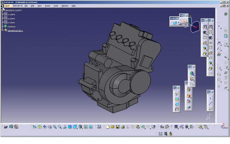

t51r, have u done the suspension parts?
what software did you used to run a simulation?
did you modeled the F4i engine in catia by yourself?

Yeah, I use Catia V5. I should have modeled the engine, however there are CAD file of that engine out there, so I don't want to waste time to model it.

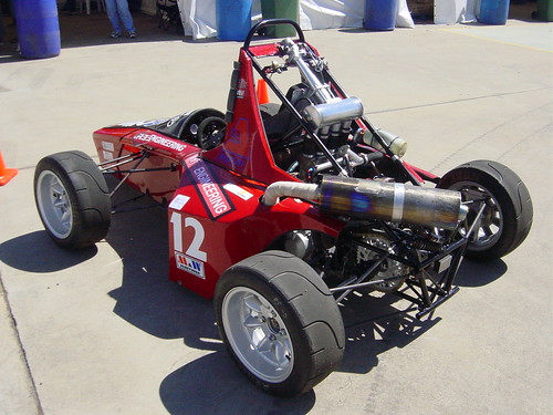

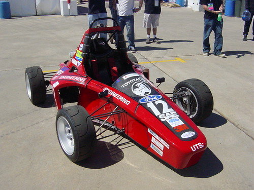

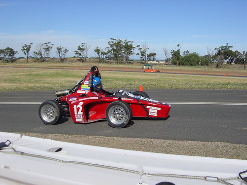

anyway... some details of the UTS 2005 car you see below..
chromemoly space frame with semi stressed engine..
race weight : 240 kilos plus driver full tank petrol and liquids
yamaha r6 engine running sequential injection Motec M800, M&W CDI
custom manifold and extractors, exhaust
110hp@wheels through 20mm restrictor and BP 97 pump gas
0-100 in 3.2 seconds
max lateral G is 1.6 with Avon slicks
that year we managed 12th place out of 30 entries..
an excellent achievement considering we had 15k AUD to build the car..
UWA that won that year had 100K...
but that aside.. most of the guys that build these cars end up with motorsports jobs...
the suspension guy on my team now works for Williams F1..
the guys on the winning teams are in F1, F3, WRC and V8 supercar..
so the rewards are well worth it..

our car was considered heavy at 240...
UWA was about 200kg.. i think they ran a kawasaki zx6R.. they also had a carbon monocoque..
RMIT tipped the scales at 175kg that year with driver... super lightweight
they used a husqvarna 450 single cylinder engine which weighed 45kg..
our R6 almost doubled that at 80kg..
so 280 will be way too heavy... i don;t think you could build a car that heavy.. unless of course you intend to follow our local roll cage builders and use steam pipe..
our chassis that year weighed 30kg painted.. so that could be a target you should aim for..
the upright weigh about 1.5-2kg each.. so aim for an unsprung mass of about 9kg..
please don;t use any brakes that are used on cars as they are way too heavy.. we used a set of willwoods that were meant for formula ford..
