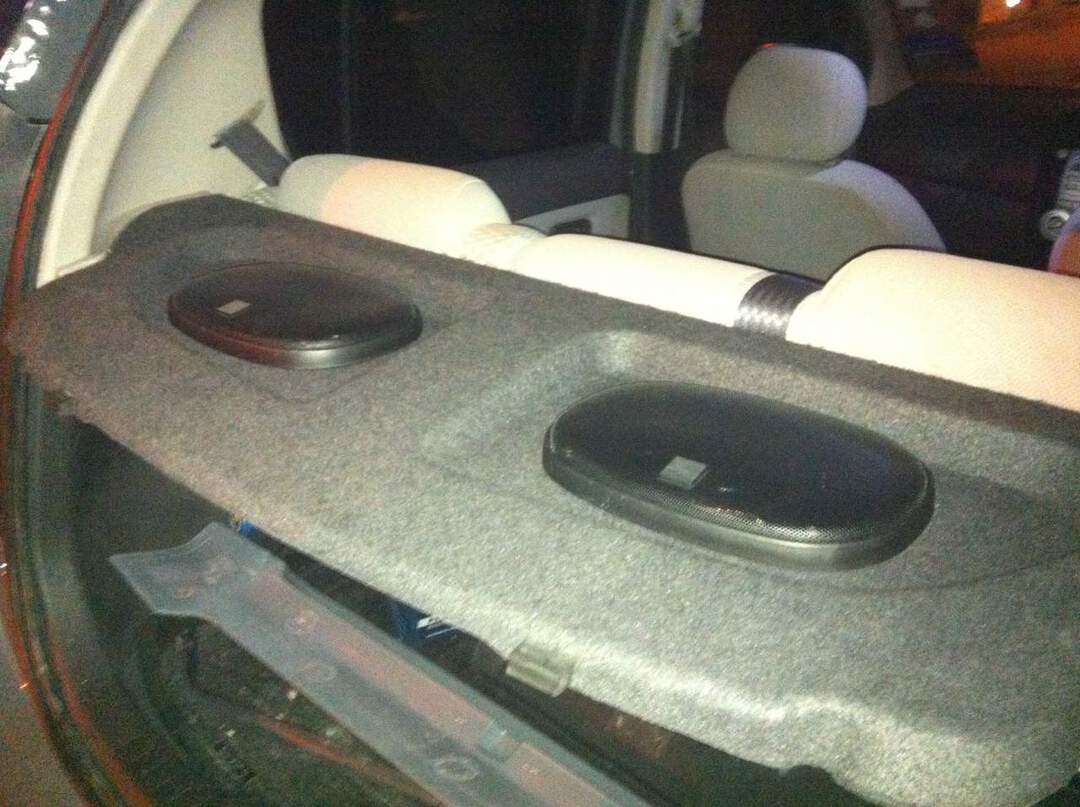

Nope. Unless you cut a hole in the rear parcel shelf, you can't fit these anywhere else.

from my knowledge, the front speakers are 4 inches, and for the rear door is 6 inches am i right? so i cant fit these 6X9 speakers in the rear door kan? so the rear parcel shelf is the only option?

If you're talking about plug and play, yeap. If you want to consider modification, you can mod your front door panels and cut a hole in the metal to fit those speakers in the front. Anything can be done when custom. hehe

6" isn't equal to 6x9. There're many factors you might want to consider before changing front/rear door speakers.

Naqi dude - there's a few things you must consider if you're gonna custom fit it. If you cut the door panels to fit the 6x9 then you'll need to either keep the car forever or replace with a new panel in future or sell as it is. Sound may not be great with a 6x9 only.

OEM speaker board? New okay, as time goes by the weight of the 6 x 9 magnet may bend it then got trouble. Mine (different car - hatchback) last time I custom made with plywood....:biggrin:
