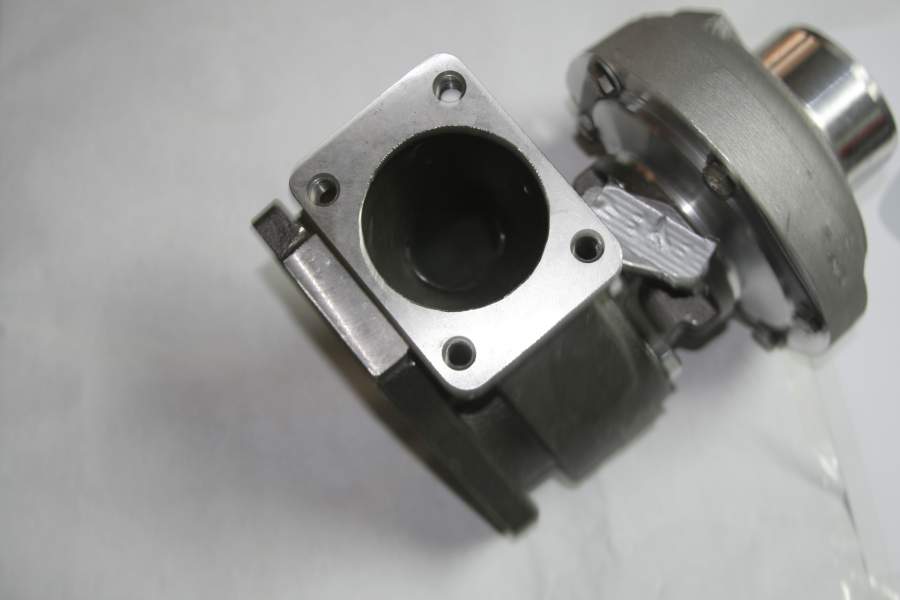

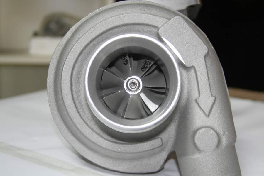

the 50trim is a 54mm inducer , 76mm exducer , compressor map looks very very beautiful
can support up to 480hp
the 60-1 is a 59mm inducer , 76mm exducer , 7 blade wheel , should support up to 600hp
if its a gsr , the 50trim will be a good bet if he is chasing for power + sleeper + standard manifold , go bullseye
