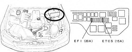

[FONT=Arial, Helvetica, sans-serif] It is recommended that the engine ECU is reset after any engine performance modifications have been made to the vehicle, including using a higher octane fuel, to accelerate the learning of any new parameters. Resetting the ECU will also clear any stored error codes, however if you have a fault with your vehicle it is advisable that these codes are retrieved rather than wiped as they may help in diagnosing the problem.

  • Make sure the ignition is turned off
<o:p> </o:p>
  • Remove the engine bay fuse box cover
<o:p> </o:p>
  • Remove the 20Amp/25Amp EFI fuse
<o:p> </o:p>
  • Remove the 15Amp ETCS fuse
<o:p></o:p>
<o:p>
</o:p>
  • Wait 30 seconds
<o:p> </o:p>
  • Re-insert the two fuses
<o:p> </o:p>
  • Install the fuse box cover
<o:p> </o:p>
<o:p> </o:p>
It is also possible to reset the engine ECU by removing the battery. but it will also reset any memory settings such as radio presets, trip mileage, clock etc..

Just to add...the positions of the EFI and ETCS fuses are not necessarily in that position, to be more accurate, always refer to the chart on the bottom part of the console box..it varies with manufacturing dates i guess..
JayDM is right, please always refer to the chart on the console box.. :regular_smile:
