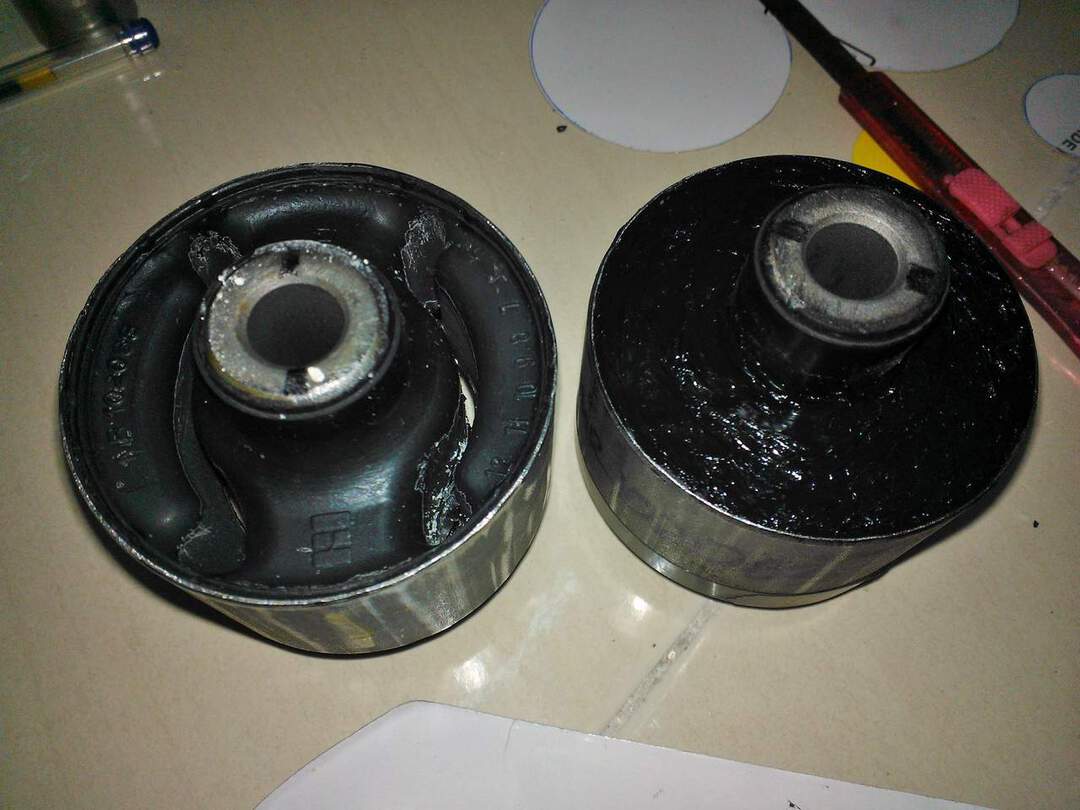

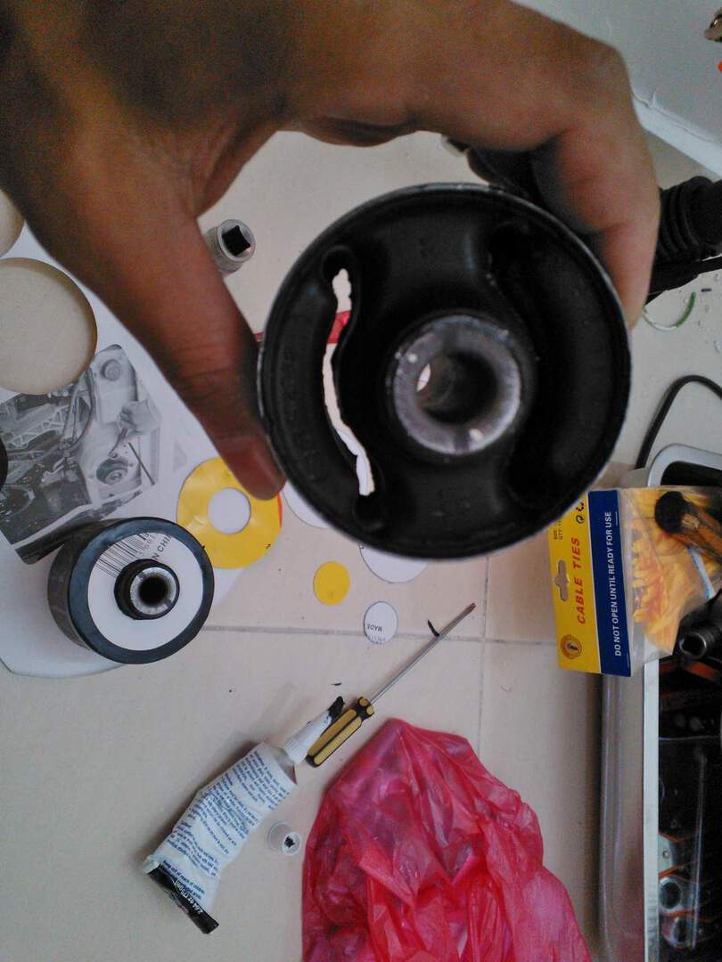

this is what i did whenever my car need new mounting/bushes...
buy oem/normal one...then fills the gap with silicon (those windscreen silicon glue)
definately would last longer than ori mounts/bushing..and much cheaper than buying those race mountings/bushings
then it will become "FULL RUBBER" mounting right?? can be applied on other mounting??

i used the silicone as well in my car,
but there is another option, to use 3M window weld. Its much more stronger and harder than silicone but the problem is its really hard to find in Malaysia, searched it at Ace hardware also dont have
Bro. pomen,
Won't vibrate? The empty space supposed to be for free play...

Bro. pomen,
if teflon/full rubber type yes it vibrate...this one feels like oem.....a bit firmer but last much longer...
can be applied to any mounts/bushings with similar pattern
---------- Post added at 03:33 PM ---------- 6 hour anti-bump limit - Previous post was at 03:23 PM ----------
still not full rubber....half rubber-half silicone :biggrin:
