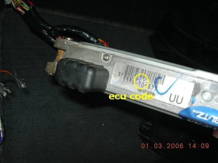

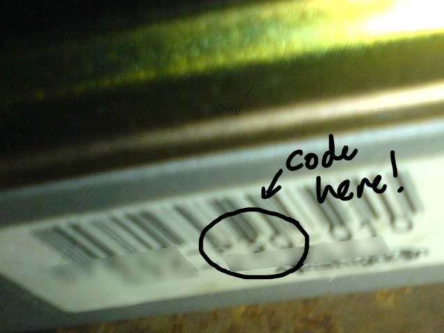

As for where the code is.. This is an ecu box sticker taken off my car. Sorry blurry.. it was hard work trying to fit the cameraphone behind the ECU box at the footwell. (aiseh.. malunya.. interior surface rust still haven't cleaned up!)
As for knowing authentic JDM EG9 or not.. check the tag in front of the radiator.. it's blue in colour, in japanese, and the tag number is the same as your chassis number.
