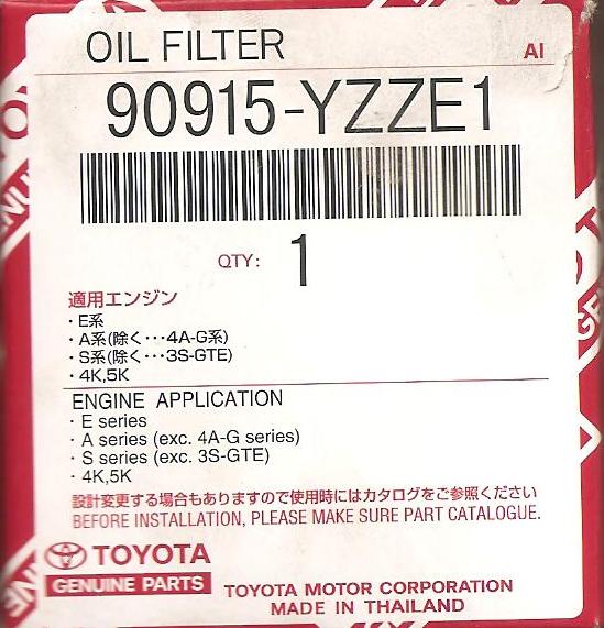

Do you notice something on this?
TRD.AE92
Apr 10, 2009
780
40
1,528
Hi there,
Please check the attachment. Do you found something wrong on this oil filter?
TRD.AE92
Apr 10, 2009
780
40
1,528
except 4age?? how come???
Yes... you are right...
I go to buy Toyota Original Part oil filter... There is Toyota oil filter is not design for 4AGE, 4AGZE, and 3SGTE....
---------- Post added at 08:52 AM ---------- Previous post was at 08:51 AM ----------
That means it is used for 4AF, 4A and such excluding 4AGE. I think it has something to do with the flow of oil.
Yes.. correct too...But It very important?
---------- Post added at 08:52 AM ---------- Previous post was at 08:52 AM ----------
the ''4A-G series'' means 4AGE also included..
Yes... Included as well

There is another version, slightly bigger than this picture. Written 4AGE compatible and for 3SGE too. I take picture on my next service. I notice this filter too, and discontinue using it. Compare to the filter that i'm using (original Toyota), it has a difference 0.2 bar oil pressure once you do the swap.
n0th1n
Feb 7, 2005
1,161
12
japan
junk-dealer.blogspot.com
last time also got difference.
C1 vs C2 if im not mistaken.
so, nowadays oil filter E1 vs E2. made in thailand
E1 smaller, and E2 is bigger
E1 murah sikit and E2 mahal sikit
technical specs? carik itu chinoze punya website. should be there.

Yeah... there are the E2, but support for our 4AG series and 3SGT series...
ermm... you have picture to differential for them? Because most of ZTHrian will not aware of it.

just a question:
- does it effect the vvt? with difference of 0.2 bar pressure

i've already change it with that oil filter too..1st look at the box make me curious too..ask the seller but they tell also can for 4age..rite now nothing different before n after change it:biggrin:

Dude, already stated not compatible for 4AG (including 4AGE, 4AGZE and 4AGE 20V). You can still fit it though, but suspect oil press will drop (more noticeable during VVT activation) and insufficient oil filtration.
Physically, the E1 is smaller and E2 is bigger. Price wise not much difference, maybe cost RM2-3 more only.

Like that tiu lo.... any problem using E1 arrr??? Just check with my mech.. he been changing E1 oil filter for me all the while....:banghead:

This is correct oil filter for 20V:
90915-YZZC6
90915-YZZE2
C6 is using sponge like filter element while E2 is using paper. Could be due to different filter element, E2 is slight taller than C6.
If using a wrong oil filter, perhaps the VVT pulley will die earlier (produce "clack clack" diesel sound)??

Different pressure needed to push the oil. I see. Flow design is also what comes to mind. Unless someone can buy one and cut it open sideways, then we can see the difference. But since the packaging already stated so, i think it is wise to follow it.

die lo... all this while i'm using E1 and pressing the oil hard....
any after effects (other than the taxi sound)?
