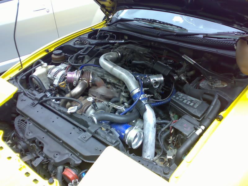

bro.. i have 1 question.. i have a rather large wasegate on my exhaust manifold.. how do i wrap over that???
my engine bay pic...
