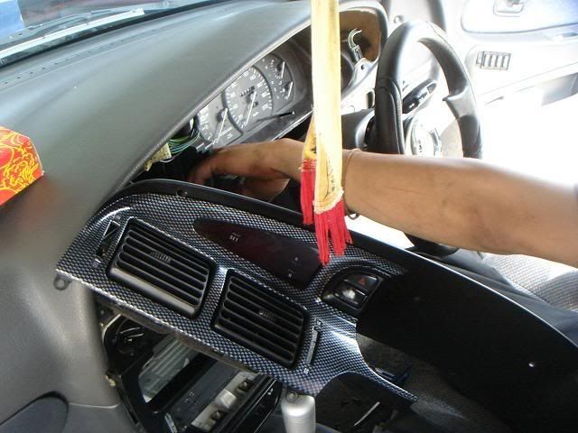

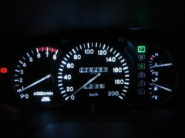

juz wana share d result of my upgrade on LED lighting...

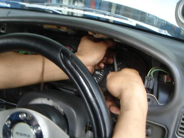

changing d led is easy, but be careful wif d dashboard panel.. bcoz is made by plastic..
from yellow to bright white...!... yippeee~~~ :biggrin:

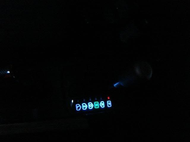

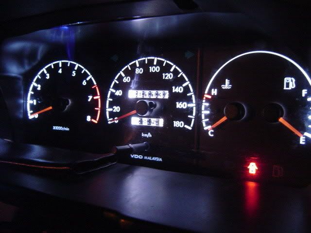

another shot... V

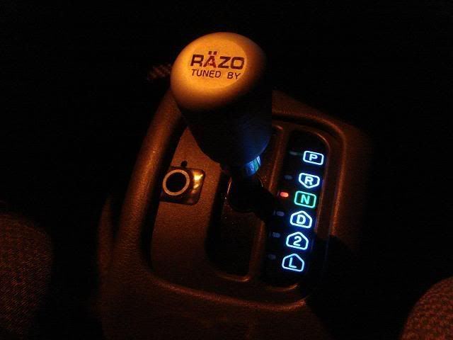

gear console only needs one t10

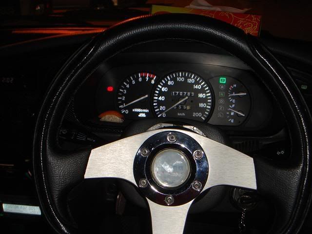

as for d meter, total 4 t10 for background... t4.2 cant remember... :banghead:

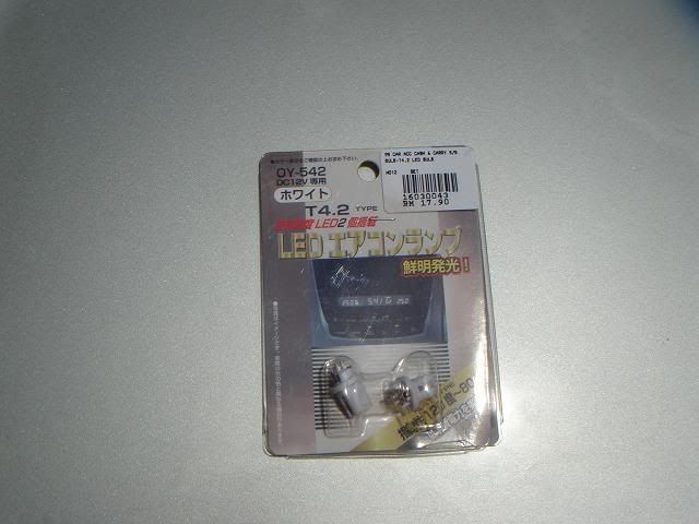

there r two types of LED needed, this one is T4.2 type.. only can use for certain indicators like:
GEAR, signal, fuel, temperature...
as for the back ground... is d common type T10.. i ll only show u d rare type.. T4.2

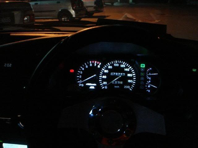

d result~~::biggrin:

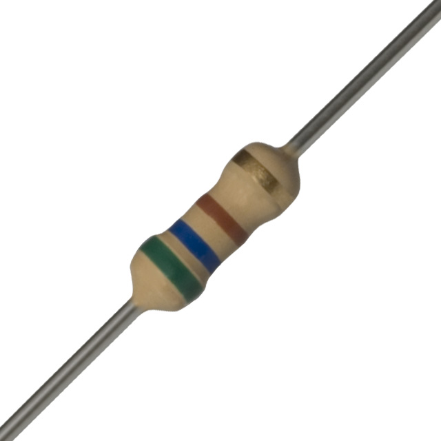

u go to electronic shop, buy a LED and resistor(perintang). u say wan convert 15v 400 amp to suit LED voltage n ampere. ask shop to find correct n suitable resistor(perintang ). 1 led about rm1 n resistor oso rm1. i try to ask wat colour of resistor i post again.

i find ord a resistor color code for convert 12 volt to LED voltage. simply u jz solder a led to led anod lead(+). u nd resistor 470 ohm.
Bump: nd correction... for LED safety use 560 ohm resistor coz car batt normally operate more den 12 v.

nice. any idea where to get that T4.2 led? cuz the more common ones are T5, T10, T15 etc. but never seen T4.2 before. Thanks!

for those who were stayin in penang...
try 99 accesories @ bukit mertajam
