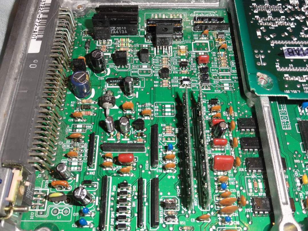

Does anyone know the part number or replacement diode for D10 and D5?
---------- Post added at 05:57 PM ---------- 6 hour anti-bump limit - Previous post was at 03:47 PM ----------
D10 Reverse polarity protection - 1N5400 (replacement)
D5 Power Surge Suppressor - 5Z27
---------- Post added at 11:33 PM ---------- 6 hour anti-bump limit - Previous post was at 11:33 PM ----------
Usually we get it from a donor board.
D5.... I have some...
Ahh...thanks Levin...I tot D5 was the reverse polarity diode... i got mixed up LOL...
E-Tech selling some D5? Isn't D5 the diode that looks like a rugby ball shape?
These are the newer parts from Sanken..
Yes it's for reverse battery protection and yes
It's for sale... PM is seriously want it.

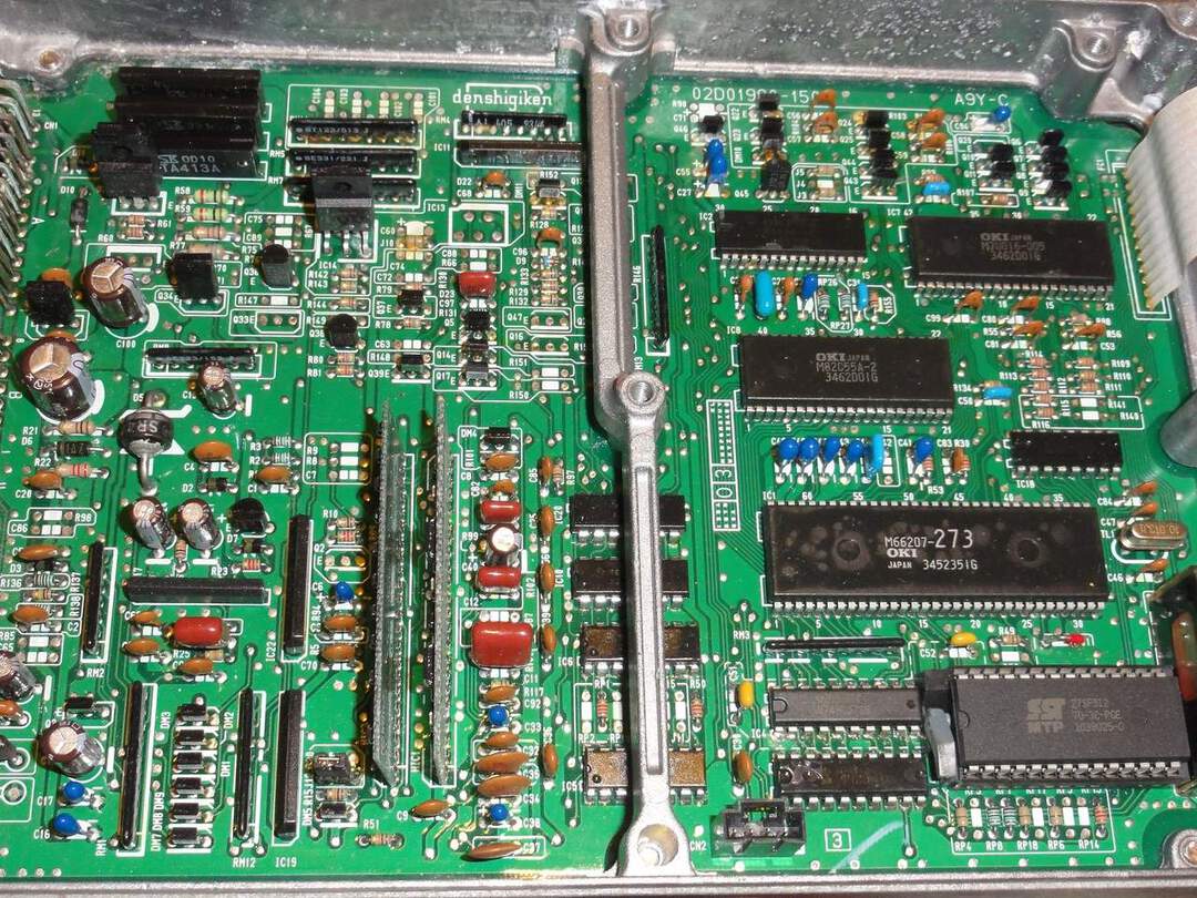

Hi there e-tech,
i have a problem with a p30 ecu,my problem is....after running the car for at least 2 hours,my car will stop by it self n the engine check won't go off,already check the fuel pump wiring,main relay etc n it's ok,no problem with it,use the jumper n jump it,check light will stay only n it won't go off or blink,I have to wait until my ecu is warm off then can start the car back as normal but only can use that ecu for 1 hour plus or 2 hour....after that .....my car won't start....I have check with some friends n they told me its my ecu problem......
Thanks
Hi there e-tech,
Thanks
The aluminium capacitors (7pcs) need to be change.
Then is still cannot the IC17 needs to be replace....
Ok?
Ok?
Can u quote the price for the 7 pcs of capacitors....n the ic17 include postage....to kl
thanks

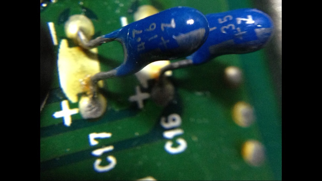

hello bro e-tech... I'm a newbie.. Sorry to ask...my ECU also P27-T00 but i use for AT car...i must for a long time before the CEL goes off... >>> http://www.zerotohundred.com/newfor...eg-1-6-sohc-repair-report.html#post1064321325
i want to ask about both of the small BLUE capacitor..(Tantalum Capacitors)..
What is the value of that BLUE capacitor.. i can't see mine coz the value is gone.... Another is about the 3 leg black capacitor the no. is D1779... i can't get it at my place.. anyway I'm from alor setar...Can i buy it from u??
---------- Post added at 05:09 PM ---------- 6 hour anti-bump limit - Previous post was at 05:04 PM ----------
hello bro e-tech... I'm a newbie.. Sorry to ask...my ECU also P27-T00 but i use for AT car...i must for a long time before the CEL goes off... >>> http://www.zerotohundred.com/newforu...post1064321325
i want to ask about both of the small BLUE capacitor..(C16 & C17)..
What is the value of that BLUE capacitor.. i can't see mine coz the value is gone.... Another is about the 3 leg black capacitor (Q3 E) the no. is D1779... i can't get it at my place.. anyway I'm from alor setar...Can i buy it from u??
Fazrul...
1uF 35v tantalum (marked "1 ... 35" and blue w/+ mark)
D1779=D1780=C2785
TQ Bro..
Sorry to ask again..
U means that both of the blue capacitor (C16 & C17) have the same value ka??

This ECU has a code 14, I swap the ECU and I am fine, there seems to be some water damage around the board but a lot of the transistors are hard to find.
I looked at your schematic earlier and noticed Q45 is part of the IACV components, it does not look bad. Can you tell me if any of the damaged parts have to do with IACV
Hi...
Your ecu still looks good.
Change the 8 pcs of capacitors should solve your problem.
Tq
