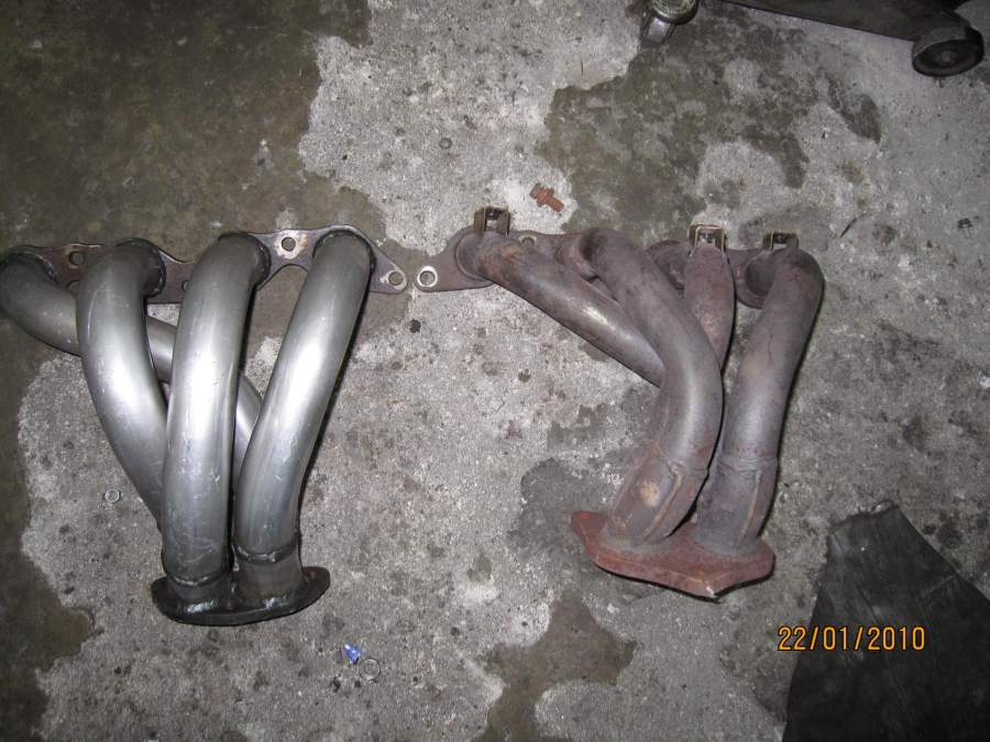

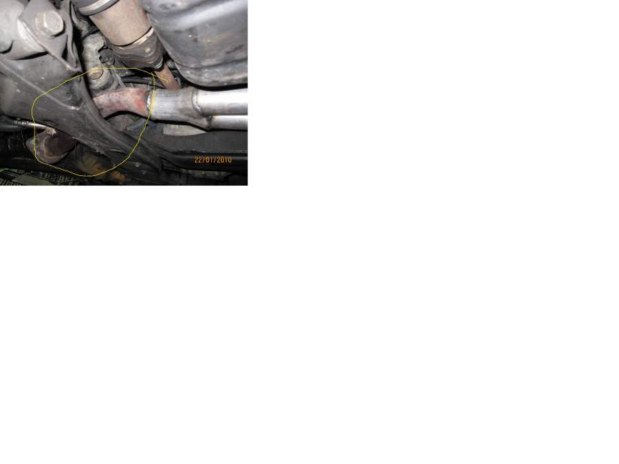

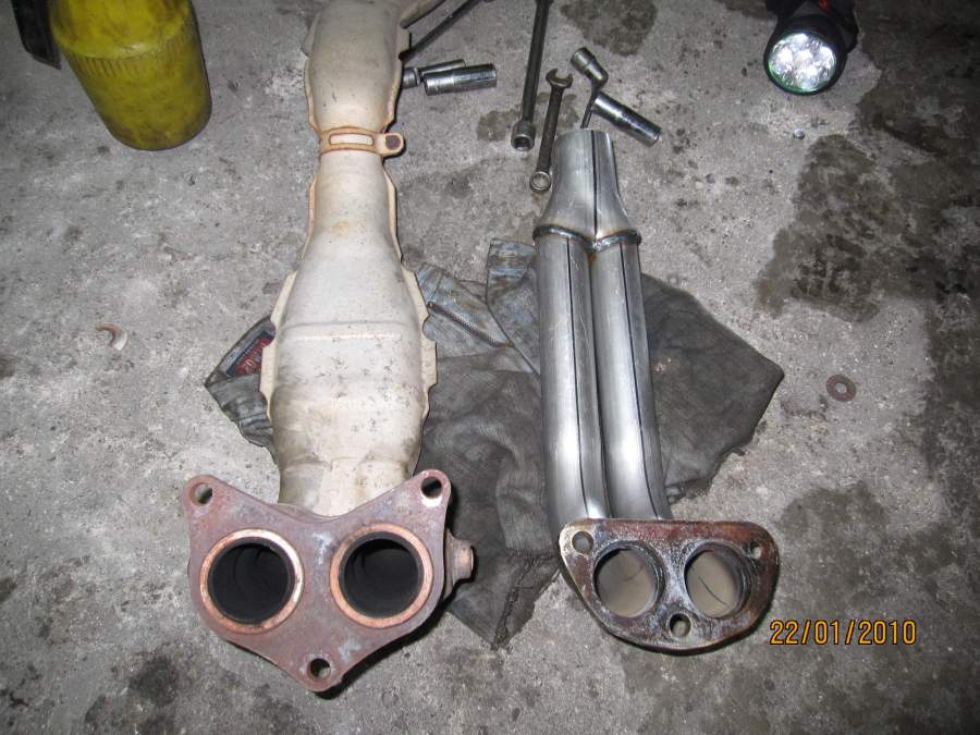

btw anyone know the piping size for stock 4-2-1 ? the 1 portion ?
my current local made 4-2-1 , the 1 portion is reuse from stock so i suspect the piping is too small..
this is the 1 portion i mention..any idea stock BT 4-2-1 header size ?

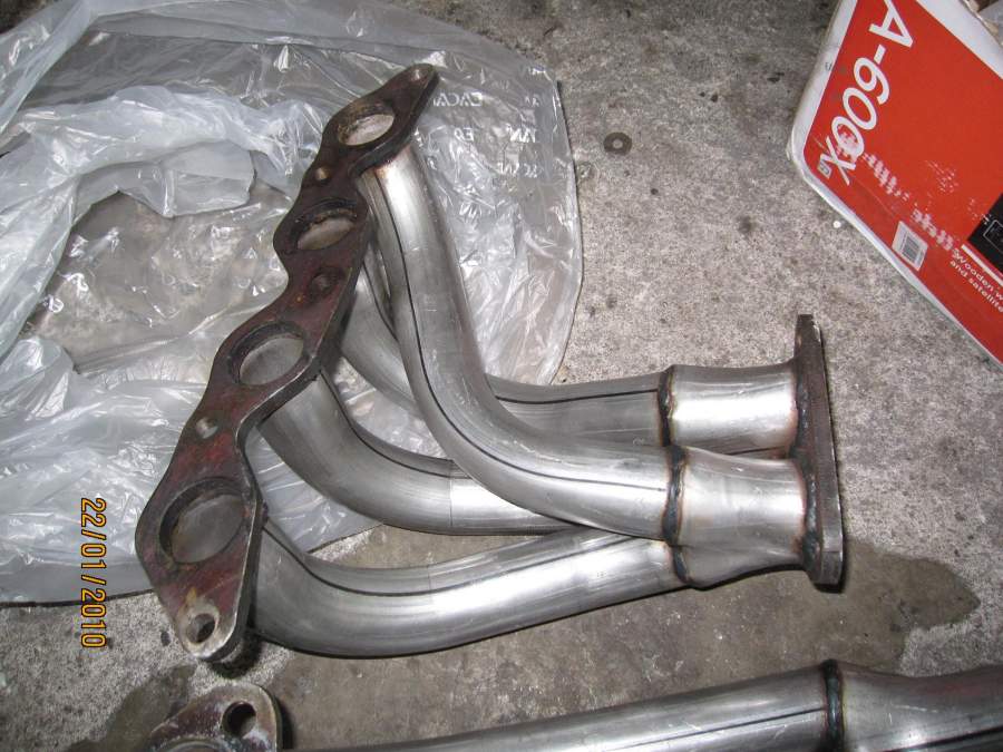

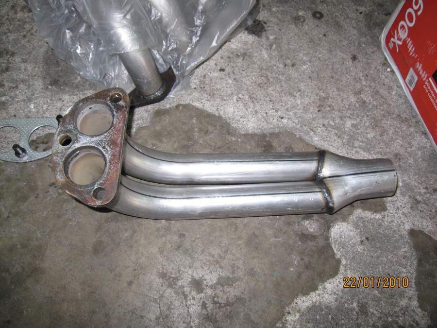

Anyways, lets see some more pictures of local made extractors for 20v. Anyone had theirs customized by Tonkka for 20V?
This is how the local 4-2-1 extractor look like.
