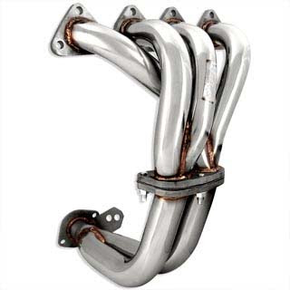

To TS, generally a 4-1 will give move the powerband towards higher regions, suitable for high-revving engines
4-2-1, broader/more useful powerband for daily driving

in general, 4-1 headers lets the engine make more power at the higher rpm ranges, at the expense of the low end; thus more suited for high-revving engines like b16/4age where the revs go sky-high
yap, 4-2-1 will generally give a broader powerband, punchier low-end and mid

if i recall correctly, i came across this interesting article where they tested a 4-2-1 and a 4-1 header on the same engine; powerband was broader, improvement throughout rpm range, more obvious on the low to mid range
then they swapped the 4-1 in; powerband became narrower/peaky, improvement mainly came from higher rpm regions

thats y i specifically stated " In General " meaning not all, and more often than not, this is true for "aftermarket" headers
there is again the matter of the primaries/secondaries which contribute to how the end powerband will look like; even 4-1 can give good low-end if the primaries/secondaries were designed to make the powerband that way, google for more info on this, i lost the article edi hehe
