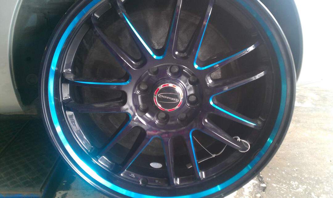

Hey sry for the late reply, i went to sunway to take a peak today on the rims. I saw a few nice ones, but its 17" so i doubt it can fit my car. Even if it can, my tyres has to be 40 instead of 45. For my stock vios rims is 14" and for the tyres is 175/65R14, if i remember correctly.
Btw, is there any 16" Sport rim for this particular design?
If Yes, where can i get it? I am currently staying in Petaling jaya, but rawang/klang/sunway is not a problem to me as i dont mind to drive down just to get a higher trade in price. :biggrin:

I think this design is quite common and should have in the market. Do you know what brand? Maybe you can ask the shops for them.
Can I give you a tip if you don't mind. Try choosing a rim with the spokes reaching the end of the rims. This will strength the outer rim lips, and the rims looks bigger (optical illusion)
Also less tiny spokes/design, so easier to wash....
Something like this....

Okay, take a look at the rims you posted. Where does the rim spokes ends? Yours ends at the inner side, away from the rims lips.
I posted similar pattern rims, The spokes ends at the outer side of the rims....
