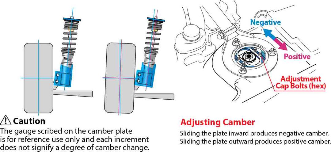

As the title suggest, I need some information from actual users of upper pillowball mounts. What improvements I will be looking at if I change my stock rubber upper mounts to pillowball type? As far as I know the accuracy of the geometry will increase. How is the ease of adjustment? and when I do adjustment do I need to jack the car up or just do with the car tires on the ground. If use on daily driven car, if there any potential problems that could arises? Is adjustment on the pillowball mount user friendly? Thanks for the feedback in advance.

as for adjustment in my case its fairly easy...only have to loosen 4 allen key...jack the car a bit (to take the weight off the shock)...slight tap with a rubber mallet...re tighten the allen key...done...
i only tried once (for the sake of trying it out) but soon after that reverted back to center position...
the down side is like yeehau point out is the noise...you can practically hear and feel every nicks and cracks of the road...the upside is handling improved quite a lot and those wheel alignment shop wont dare to scam you to buy those crappy chamber adjuster nut anymore... lol

How do you reference the markings on the plate, each mark is how many degrees? if adjust without using an alignment machine
bera
Oct 27, 2007
822
229
1,543
better do it with an alignment machine at least once so that you get the general idea each marking adjustment effect how many degree...because typically there is no standard reference for the marking...it also may differ from vehicle to vehicle...
