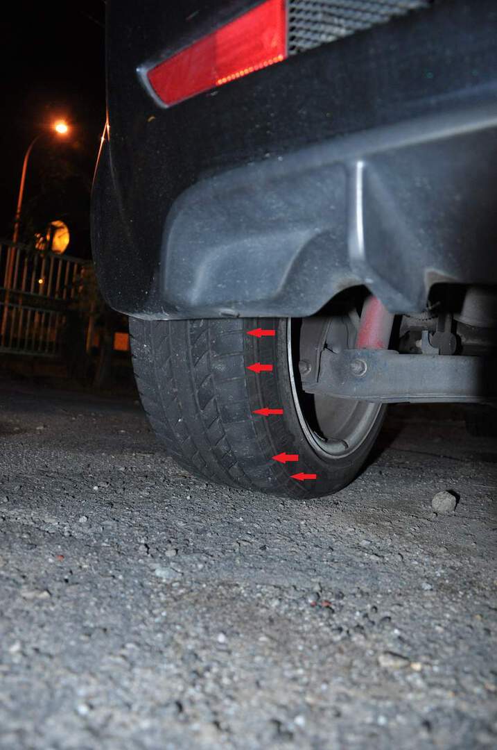

can someone explained to me how come the rear tyre not balanced worn out....it like "worn out...normal...worn out..normal" btw im using adjustable suspension. is it problem with my adjustable?

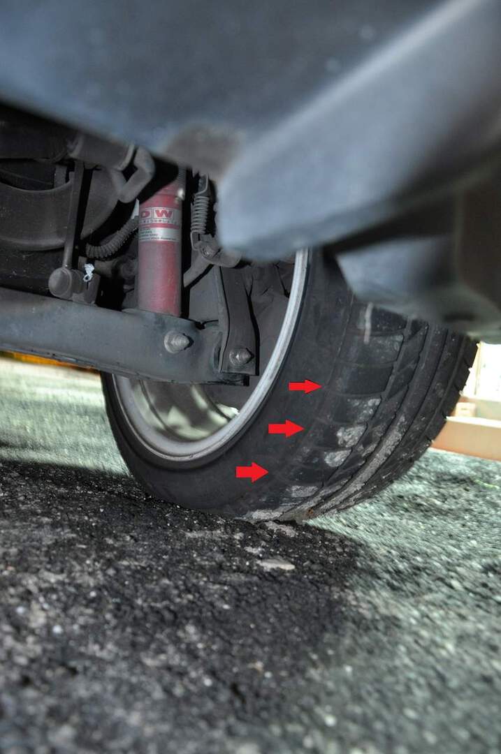

here the picture...i hope mr crazyfrog can solve my problems
ohh satria neo ke..
okay like this.
first of all
check tyre pressure; front 32psi rear 30psi.
assuming all height adjustment is correct..
you're gonna need negative camber at the rear wheels, -1 to -1.5 degree each wheel ( assuming front wheels' camber is also around the same range as the rear )
0.5mm toe in for all 4 tyres.
front right hand side tyre 0.5mm "toe in"
front left hand side tyre 0.5mm "toe in"
rear right hand side tyre 0.5mm "toe in"
rear left hand side tyre 0.5mm "toe in"
so, total toe for rear wheels should be 1mm "toe in"
same goes to the front wheels. total of 1mm "toe in"
hope this helps.

thanks for these info...btw i also change my rims that use 7.5 inch for rear and 7 inch for front still use 16 inch rims..some mech says i should pump air 32 psi front and 33 psi rear....and the the chamber i didn't do anything to make it "terkeluar"...it it possible these rims can make tyre worn inside? :confused:

u did alignment/camber adjustment after change absorber or before change absorber last time???
seems to mee like too much -ve camber.....for satria neo stock setup rear camber is -1.0degree if i remember correctly...if around -1.0 or -1.5 still okay...but if -2.0 or more it surely what u see on the tyre
