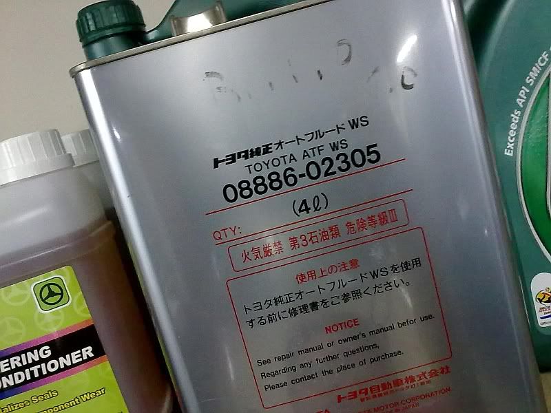

Guys,
last night i spotted another diff type of Toyota ATF... NOT "TYPE T-IV"
* update*
Category: Transmission Fluid.
Product Name: TOYOTA ATF WS.
Part No: 08886-02305
Volume: 4L
Packing: steel can, 6pcs/1case
Description: genuine automatic transmission fluid specially formulated by Toyota Corporation for vehicles with slip control transmissions which can lock up at low and medium speed. These are mostly 6-speed, sometimes 5-speed automatic transmissions and automatic transaxels widely used by Toyota in large sedans, SUVs and hybrid models since 2005.
Transmission Codes: A750H/F*, A760E, A761E/H, A960E, U151E/F**, U250E, U341E, U660E/F, P112, P310, Q211, L110
*For transmission type A750F mounted on Land Cruiser-100 built before August 2003, use Toyota ATF Type T-IV.
**For transmission types U151E/F built before August 2003, use Toyota ATF Type T-IV.
Complete Model Application:
Lexus LS: UVF45, UVF46, USF40, USF41, USF45, USF46.
Lexus GS: GWS191, URS190, UZS190, GRS191, GRS196
Lexus HS: ANF10
Lexus IS: GSE20, GSE21, GSE25, USE20
Lexus RX: GYL15W, GYL16W, GGL10W, GGL15W, GGL16W
Lexus SC: UZZ40
Alphard: GGH20W, GGH25W
Blade: GRE156H
Camry: ACV40, ACV45
Camry: ACV40, ACV45
Celsior: UCF30, UCF31 (2003.5--)
Century: GZG50 (2005.1--)
Crown: GWS204, GRS204, GRS202, GRS200, GRS203, GRS201, GRS184, GRS182, GRS180, GRS183, GRS181
Crown Majesta: UZS186, UZS187, URS206, UZS207
Estima: GSR55W, AHR20W
Harrier: GSU30W, GSU31W, GSU35W, GSU36W, MHU38W
Hilux Surf: GRN215W
Kluger: MHU28W
Land Cruiser-100 (2003.8--): UZJ100W, HDJ101K
Land Cruiser-200: UZJ200W, URJ202W
Land Cruiser Prado: GRJ120W, GRJ121W
Mark X: GRX120, GRX121, GRX125
Mark X Zio: GGA10
Prius: NHW30, ZVW30
Ractis: NCP105
Vanguard: GSA33W
Wellfire: GGH20W, GGH25W
Note: available in 4L and 20L packing.
so... stay away from this ? or can try ?
