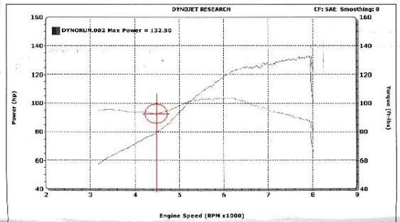

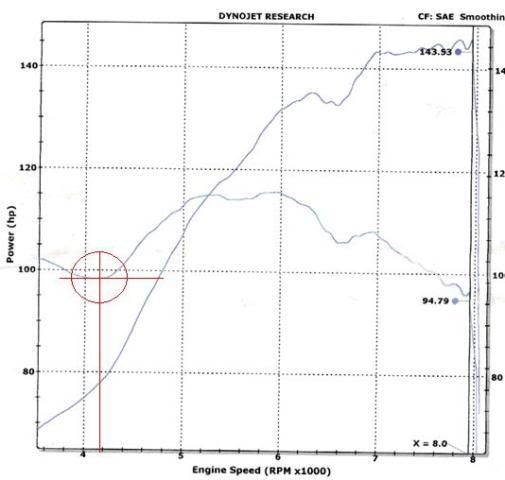

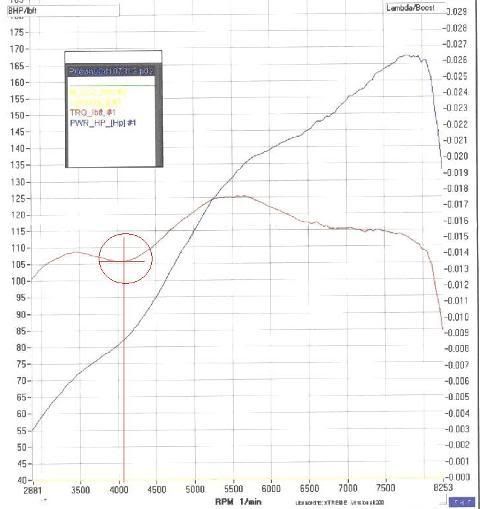

my problem is when my car rev til 4000rpm it's start to choke a bit and some power loss
this is the behavior of 4age 20v engine. VVT engaged at 4k+rpm
see the dyno chat.
Join the TT and test drive ppl car to see whether the same problem occured
do a dyno to check the AFR
