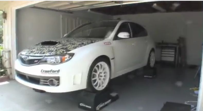

I watched Youtube videos depicting how UR installs swaybar/anti-roll bars. In them, I see the cars getting jacked/raised above ground level for the bars to be installed. Final tightening were performed with the wheels off the ground.
Can't help wondering how this can be correct. With vehicles off ground level, the cars aren't at their normal ride height. If you tighten & lock the bolts in this position, when the cars are returned to their normal ride height, the bar should experience some movement. Will this not induce some preloaded twist into the bar?
Any thoughts guys?

ARB are not tighten to a fixed point where there is no movement. It supposed to move to counter the right to left and/or left to right, so to me no issues

A bit difficult to put into words what I mean. Please have a look at this youtube video. http://www.youtube.com/watch?v=S-7whf5jCd4&t=42
In the video, it showed the swaybar end link at full droop. With the wheels off the ground, swaybar hole vs endlink will be misaligned. If the bolt is tightened at this position, when the car is lowered back to it's normal ride height, we're preloading the bar with some unwanted stress.
