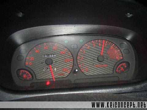

yesterday try top speed again, my fren told me roughly reach 160km/h.
i don't believe it lohhhh seriously. some more 4 ppl in the car.
want to chech my speedo meter first.
i think should be cacat ledei the meter.
one more question, what is the boost level of stock L2?????
any accurancy difference, if i use the cap ayam bosst meter and the branded one????
won't be much different right???
may like tokei_fiber said that japan ppl had modify the engine liaw.
my full boost is 0.8 bar. izit standar?
