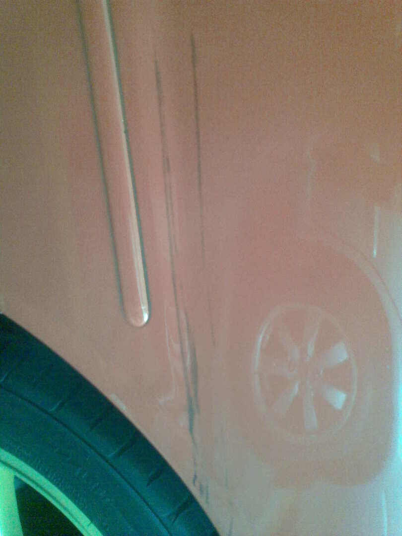

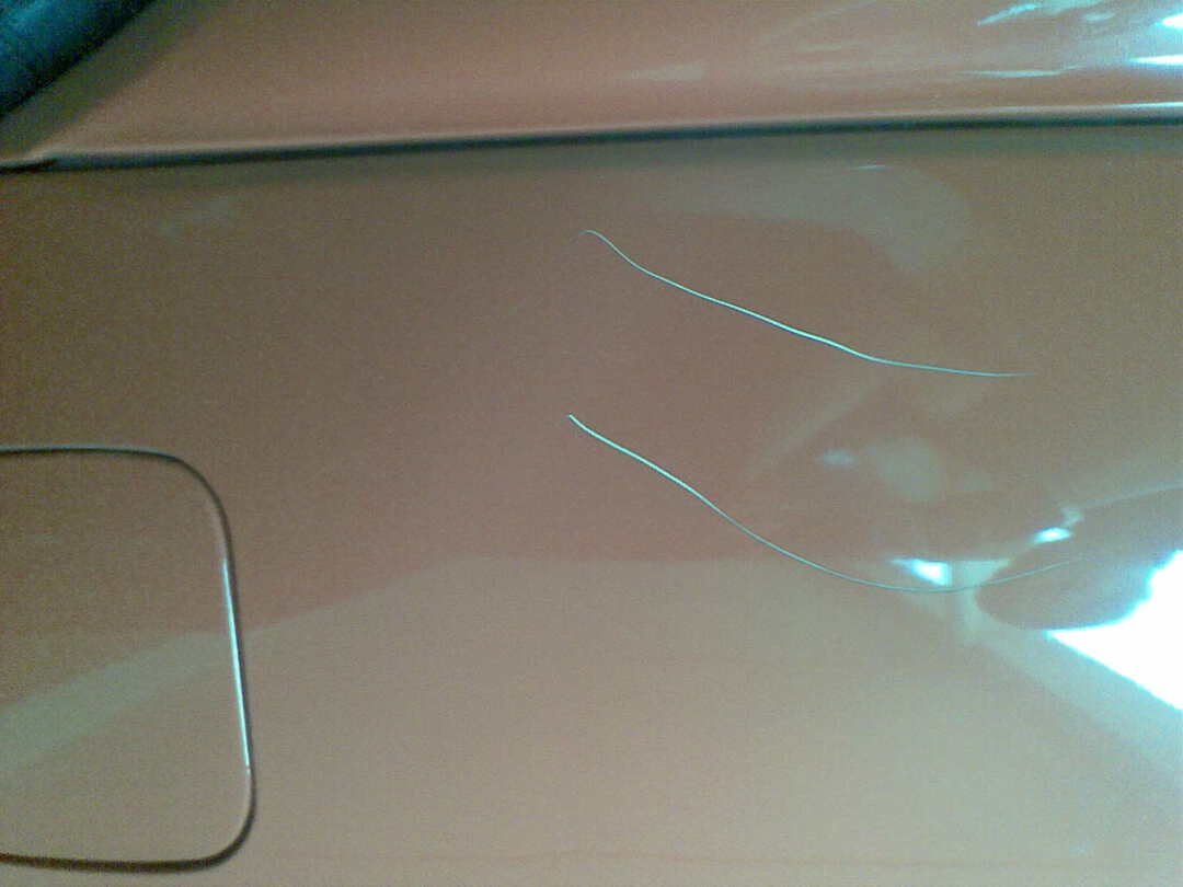

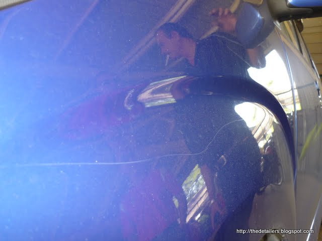

I received a distress call from my friend that someone knock & scratched his front fender & get away.......Ok ...i will come.....step one "giving hope to others is a powerful thing"
closer pics

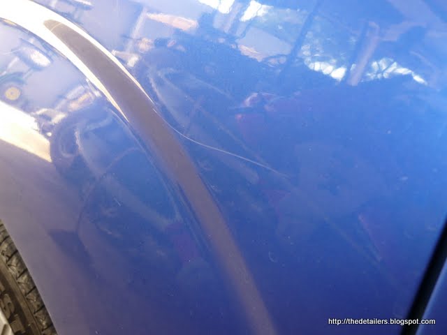

ta da....hand polish off with M 105
M 105 ( a professional body shop range product)
followed by M 205 another pro body shop range product - to smooth out the coarse surface

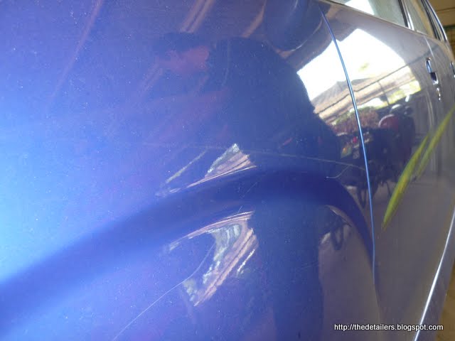

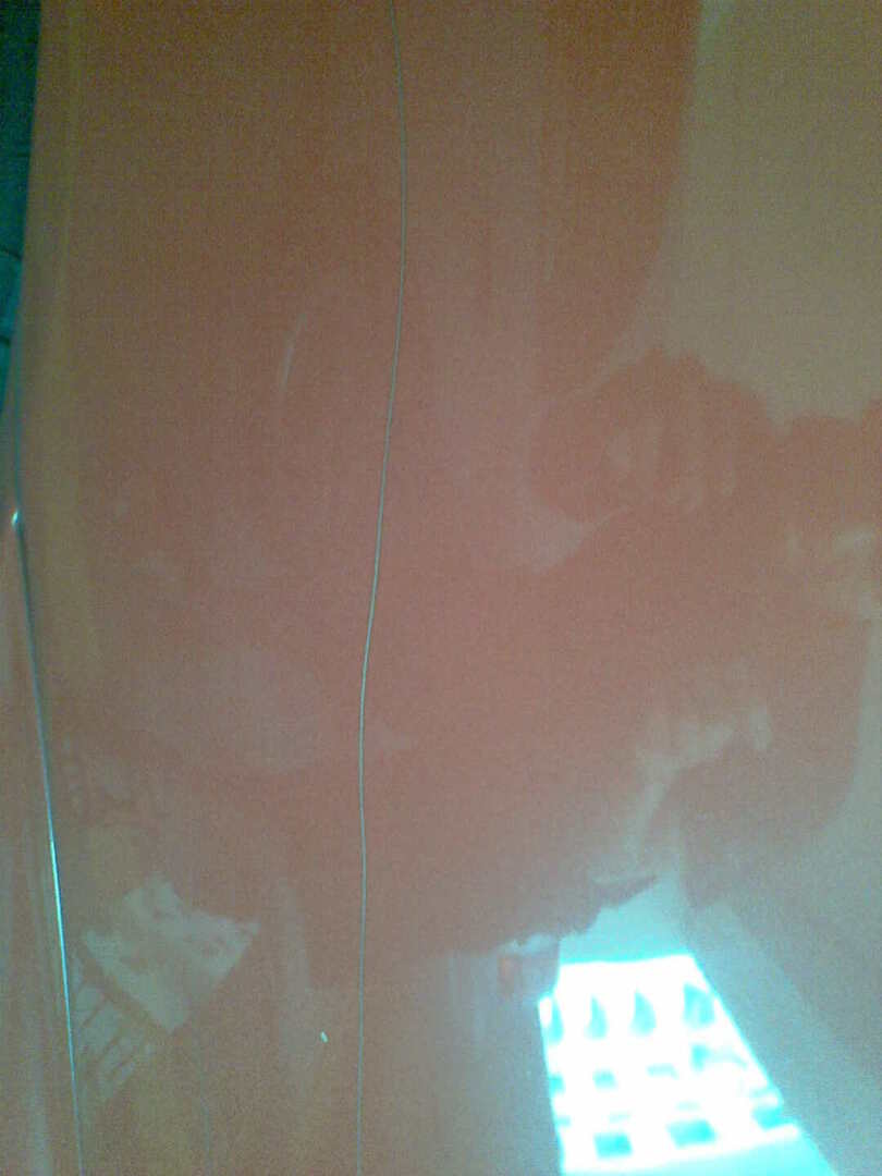

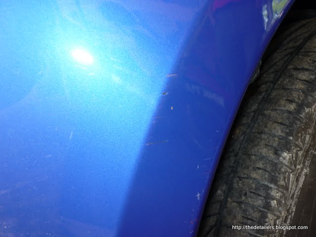

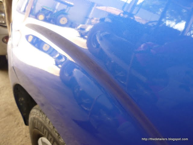

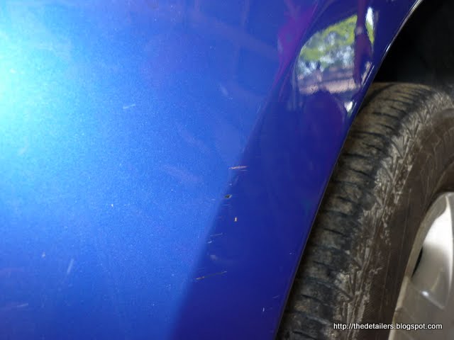

another irritating things...when some icthy fingers damage
its kinda sick thing

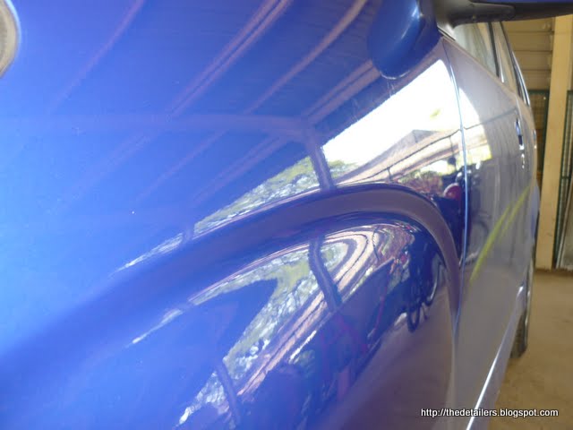

ta da....after hand polish off with M 105
sickening ppl
another scratched
thank God, it can be restored otherwise...another history...you know how when it is repainted

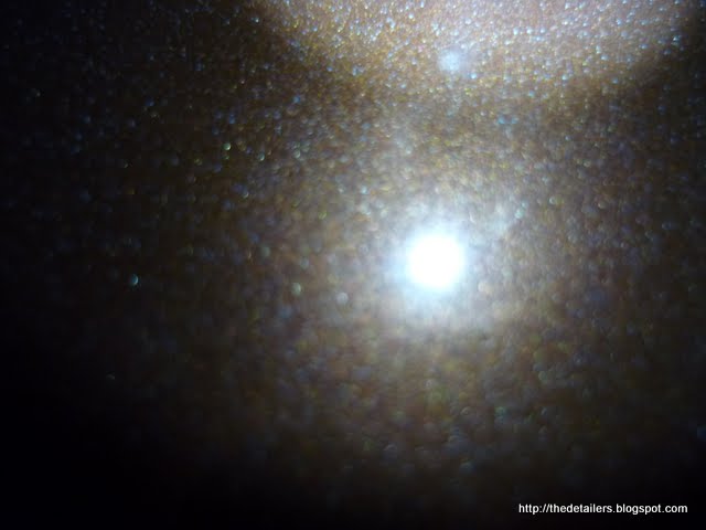

ehhhh....cant really capture well,,,,but u can feel the whole car as though like sand paper......coarse like tar road
i demo the onr wash for him & seech took out his clay ................
u know the rest........seech showed him what to do & the owner did & happily took a bottle of ONR & the very next day, he went to hyper mart to get the clay & the whole issue ressolve

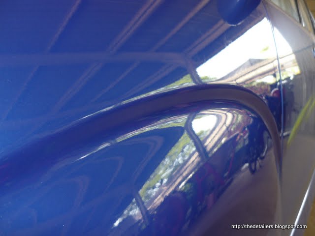

finish pics

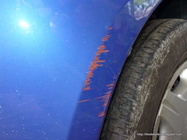

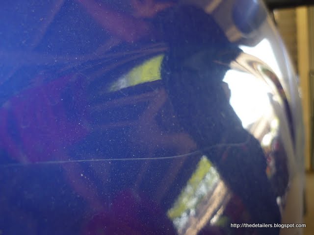

[H] [K] [S];4308616 said:
As promised... Sorry pics taken from my crappy phone.
pics sequence
1 2 3 4 5
6 7
only 2-3 might not be able....as the cut scratched has reach the base...AKA no more paint
the rest are paint transference....stand high chance to restore them to glossy look
