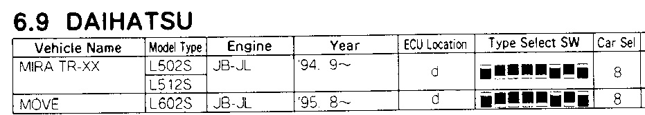

hi all..does anyone know how to set the car select and type select at the back of the safc 5 button for mira L2?:hmmmm: tq

hi bro..i didn't manage to get the tach signal from the N- pin...i tap the rpm signal from the IG pin..wonder y the N- didn't produce the tach signal..do u think the ignition system got any problem?and what is the IG stand for?is it ignition feedback?tq

todamax I had the same problem and had to do the same thing that you did, since it's working fine,i'll jus stick to that.

so where did u tap the rpm signal?

is it same the car select and type for L902s Jb-det 4 piston with L2 or L5? cuz my 5 button the rpm (red lamp) not working...:hmmmm: & can or not to modify the safc to remove the boost cut? help me..
