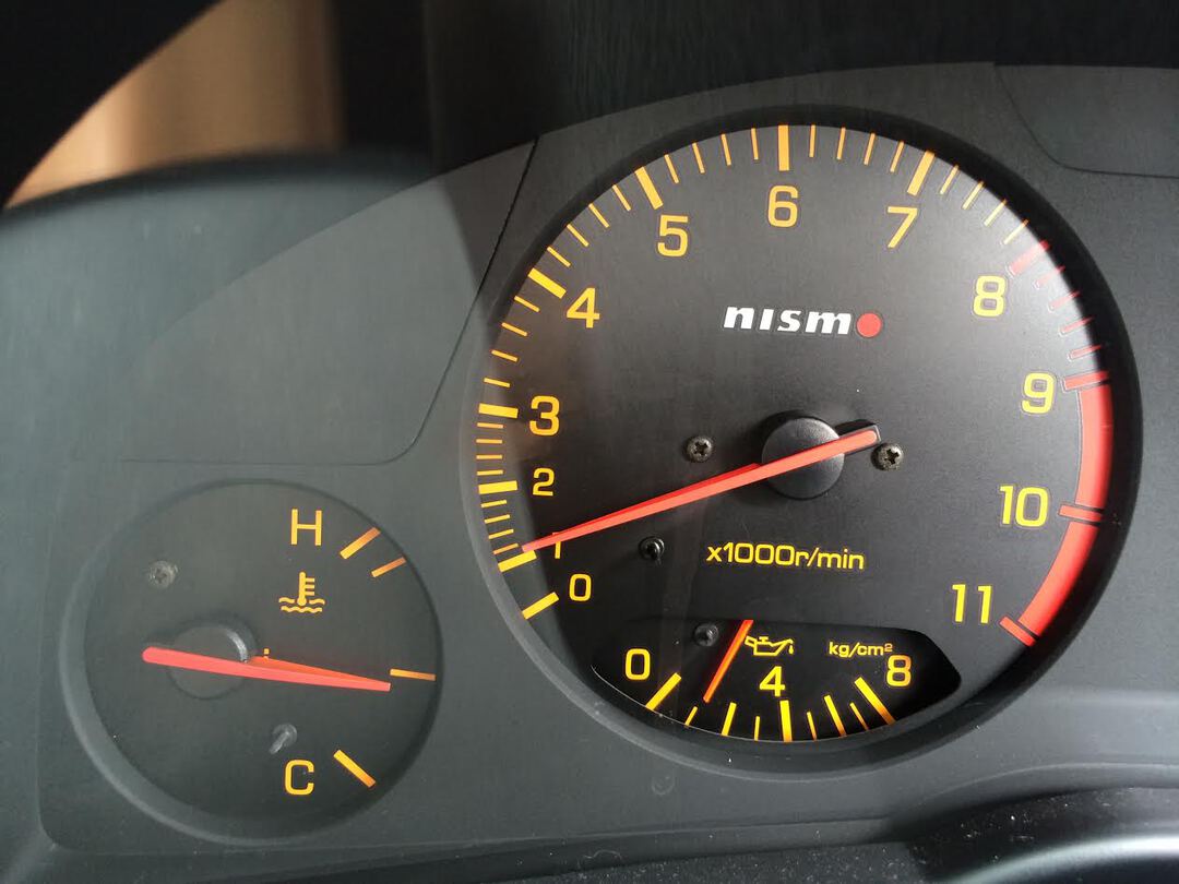

Hey guys:wavey:,
I'm driving a R34 and as of last month my oil press is reading slightly below the norm. It's reading at less than 0.8-1 Bar on normal driving and 1-less than 2 Bar on cold start. Somehow it's showing early sign off oil pump failure.
The purpose of this thread is I want to get opinion from the sifu's and other RB's user regarding their oil pump upgrade. Cz im contemplating between should I just settle with N1 or higher ends like HKS or JUN or REIMAX that'll cost a bomb. Hope to hear it from you guys soon.

Shark79: I'm running on 500Whp bro. and im just worried of the reading that my oil press gauge is showing. It could be the sender unit to the meter cluster but i dont want to take any chances. haha

Hi Angle,
When you said you are running at 500whp, for sure your oil pump is not standard anymore. N1 oil pump reading similar as per your reading right now unless if you done some modification to add washer in the oil pump, the flow much more better. Tomei is quite expensive but you also may consider Nitto (JDM Autolink got stock) since the pump is new technology than others.
BTW who done you engine? yourself or previous owner?

Hey bro, thank you for your reply.
Im not sure if it has been changed cz the previous owner did not mention anything about it and the reading seems kinda low (from what i asked around). But you could be right.
The previous owner was the one who sent it to be tuned but i myself met the tuner and asked about the car and he cant recall much. lol
