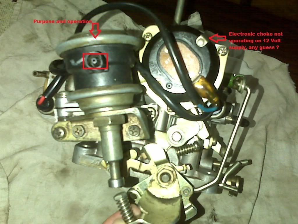

double barrel down-draft single carburetor... looks like mikuni or solex carburetor... hmm....
install to ur engine??... what engine u running??..
purpose and operation: idle load compensator... control aircond on idle revs i think...
electric choke: u sure its not working??...

Bundle of thanks for reply. I applied 12 volt on Electronic choke blue wire but no movement, is this the right procedure or advise. I am doing an expedition with my FJ40 4.2L as it carb has gone bad and beyond repair due parts unavailability, another aspect is fuel economy.
