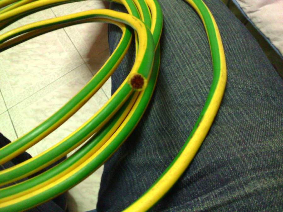

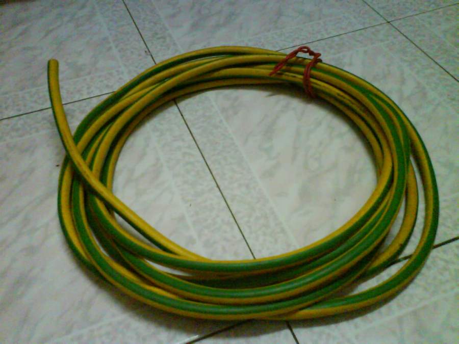

some mention that the cables being used to pull from the front terminal to da back got to be 15AMP, is that so?
what will happen if me use higher amp cable or low ones? just a question,
I got a cable here with me, but not sure can use or not....as to whether the amp's of it.
This is what written on the cable: "Lead Free HO7V-K 35mm" its looks like yellow and green stripe on it like earth, this been supplied by a friend of mine who is working with Broadcasting and Transmitter [they use this for grounding the transmitter]
Do help with this please :driver:

too small..get the bigger wan..if possible get Benz or Bmw cable..
its 35mm...? you reckon is not good enough? should i go for bigger 'mm' or by 'amp'??

i think too thin ler....try to find the same thickness as the ori battery cable..for grounding purposes its a good size....i itchy wanna DIY this also lar....

15AMPs a little too low for it. I bought welding cables, need to double check the size but the core thickness(not the outside thickness which meant nothing) is thicker than yours.
Mine had been running battery at the back since 4 years ago.

too thin ha, emmm oh ok ... im gonna measure the original cable and get something similiar then..
so i should go for the core thickness, and 15amp's is tooo low you reckon, ok ..what would be right core size and amp's should be? im using NS70 drycell.. ;-)
im just worried if the amps/cable thickness would eat up the power distribution for the whole care :hmmmm:

Should get a thinker set of wires as if too thin (minus the total resistant during the current transfer from rear to front) should try on welding wires instead cuz i experience once thin wire will melt easily and not reliable at all. So welding wires should do the job and have a insulator on the outer layer to avoid contact with the chassis.
