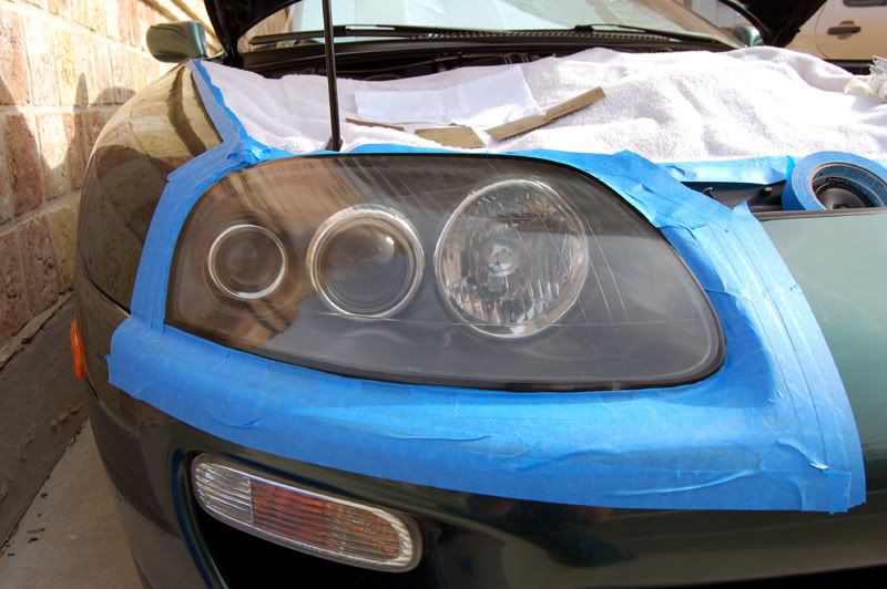

This is the actual pic of my headlight:

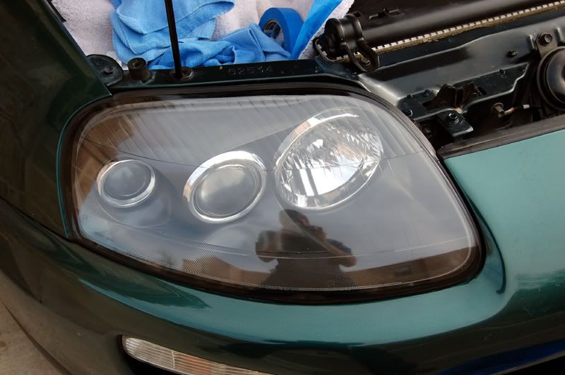

This is an image I googled:

From the pic it may appear that there is condensation and fading might not really be the problem...
Check the rear to ensure all the sockets are properly locked in to keep vapour from entering

condesation appears if there is a crack where a little rain water sips in or car is parked in extreme weather changes. cool outdoor mornings & hot extreme afternoons. there is a little drain plug (on the underside of the headlamp to release the trapped condensation.
i'm sure you may have come across this.
