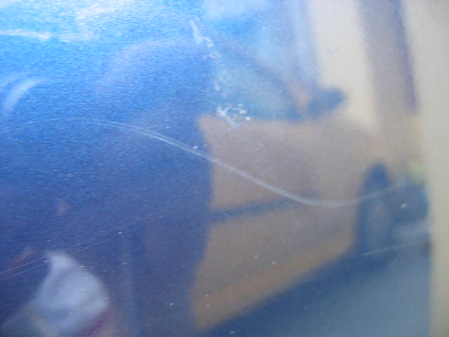

The paint was very dull, heavily oxidized, hardly look like a titan blue & rear 1/4 has lots of splattered paint on it, hard water stain

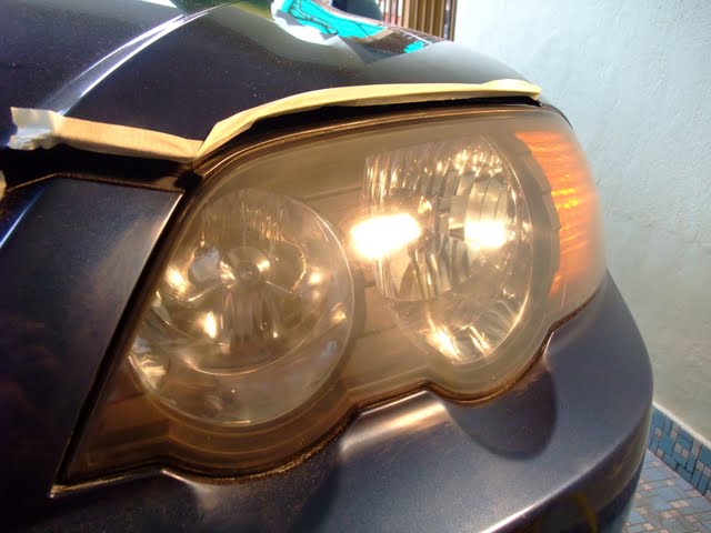

Front head lamp was sanded by the owner while trying to remove the oxidation & the bumper & hood was scratch too.....another request from my Friend is to detail the engine & stained windows

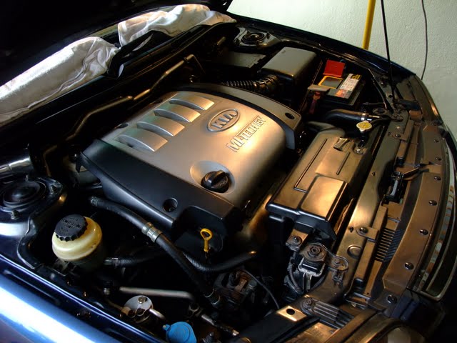

one very encouraging place to view is a very clean engine
regularly detail by the owner himself

head lamp attempt correction by the owner - some over sanded
later was corrected by seech

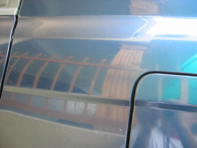

left rear 1/4 area...paint splatted

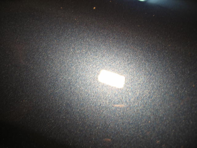

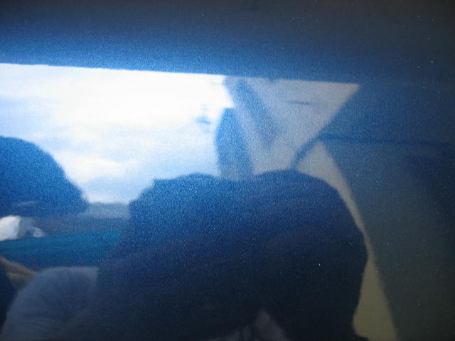

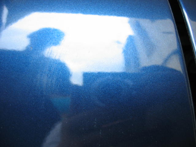

the paint is very coarse & dry
when we tries to compound, the pad as though like spider webs, got stuck on it...sticky dried surface
quick tips......constant pad spurring was great to break loose the residue & smoothen the process
Master Chef Seech - compounding with care

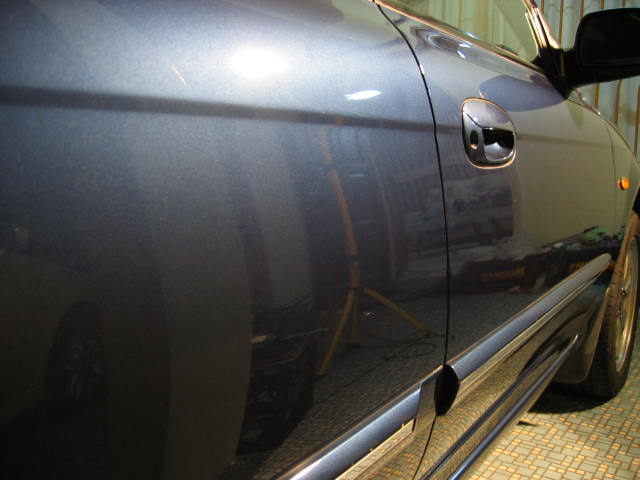

Meguiars M 105 with SOLO Burgundy wool / Rotary Speed 600 to spread/ 1000 working with pressure & 1400 slower movement with little pressure

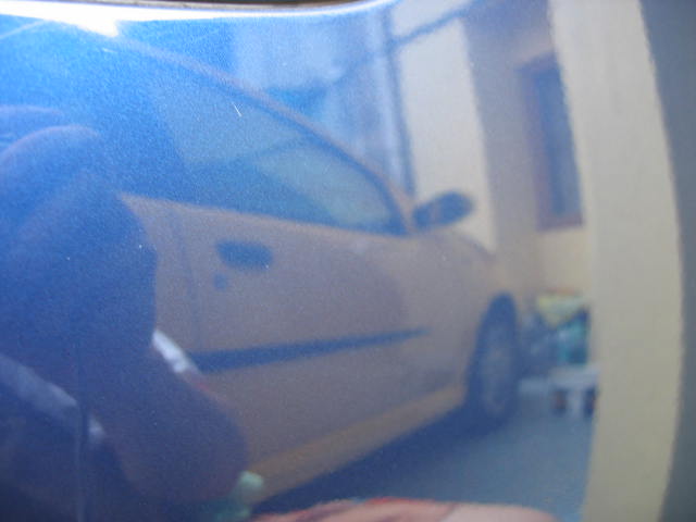

results - Ma ma mia (50/50% pics comparison)
Me - for the entire whole car
Meguiars M 105 with Lake country Double sided wool pad /R - 600 spread/1000 pressure - slower movement / 1400 moderate pressure movement

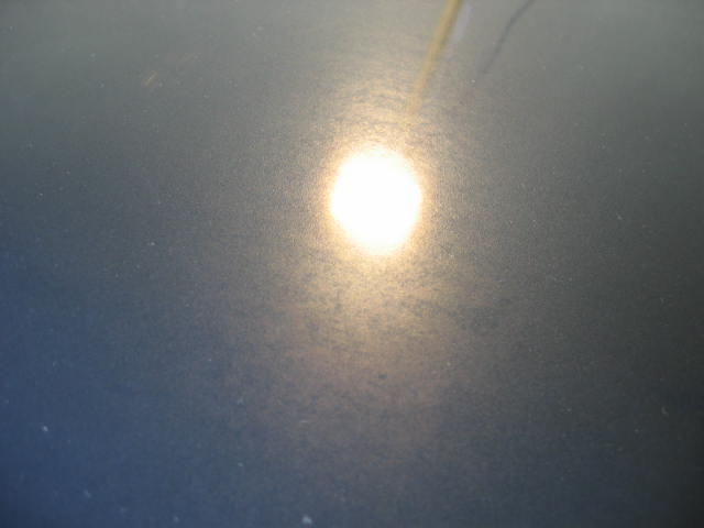

Polishing -
After a good cut, we feel this c/coat need a good lubricity polish oil - we reckon Meguairs M80 will do a good job with Soft buff W8006 - in resulting ma ma mia

Head lamp & plastic correction by Seech - i will leave it to him to share

as you can see that there is some heavily oxidation & clear coat wearing out - whitish spots in the centre
cloudy murky surface.......remind me of the song

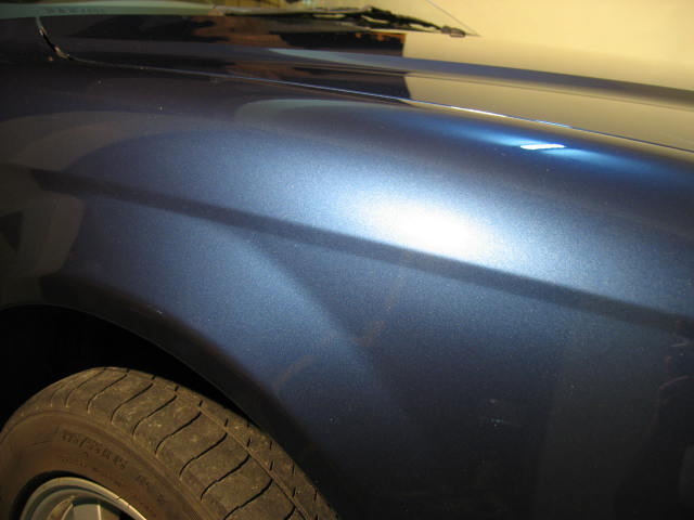

NOW after touch by Seech TLC
extreme close up shots - seech at work
ma ma mia
ta ta ta

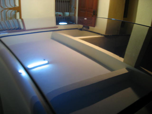

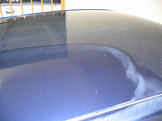

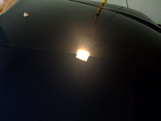

The roof
closer pics
as the neighbour paint his porch & even ignore these damages

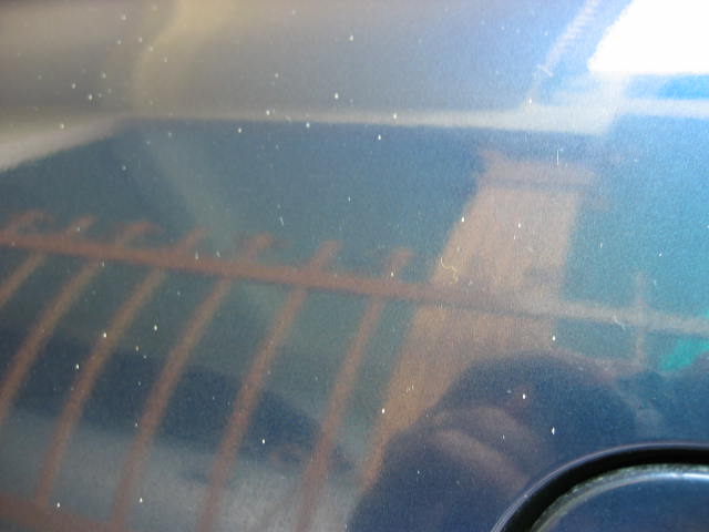

pics before
more tiny little spots
pics after
another dents & paint removal
before pics
pics after- ta ta ta

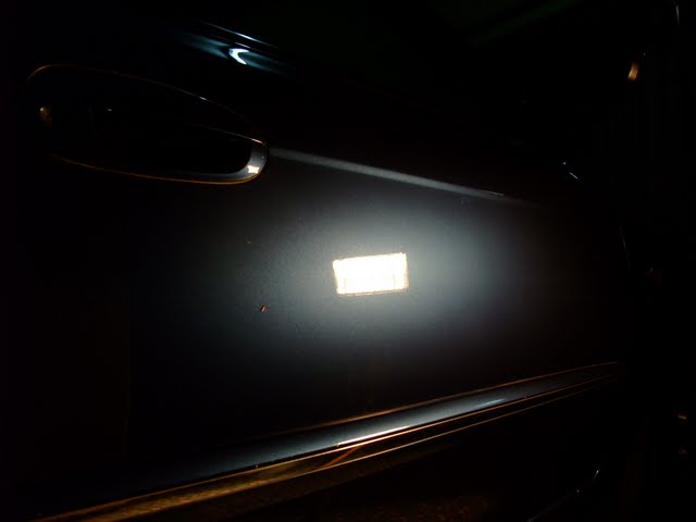

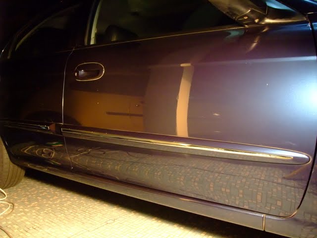

some of the side door
after corrections

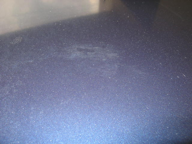

Scratches corrections
pics before
after

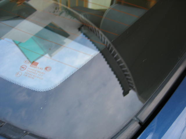

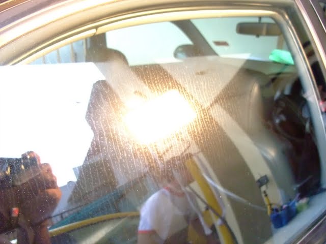

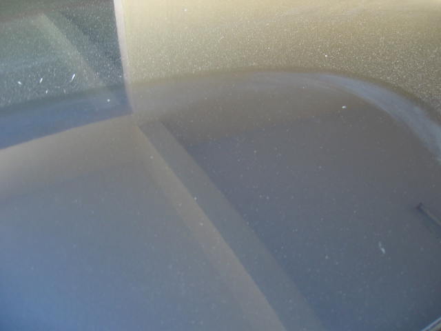

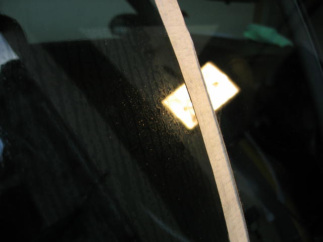

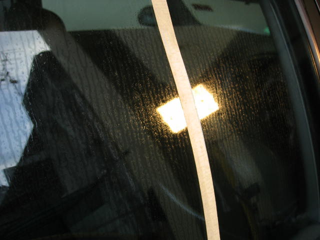

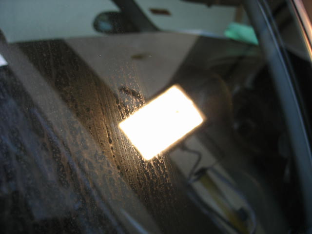

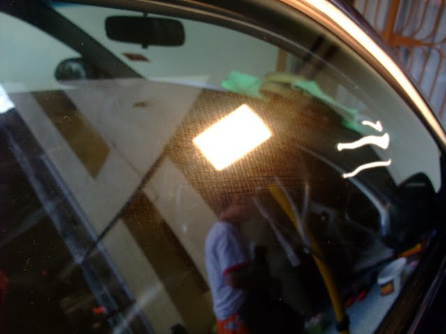

Water marks & Hard stain removal
Pics prior & before corrections

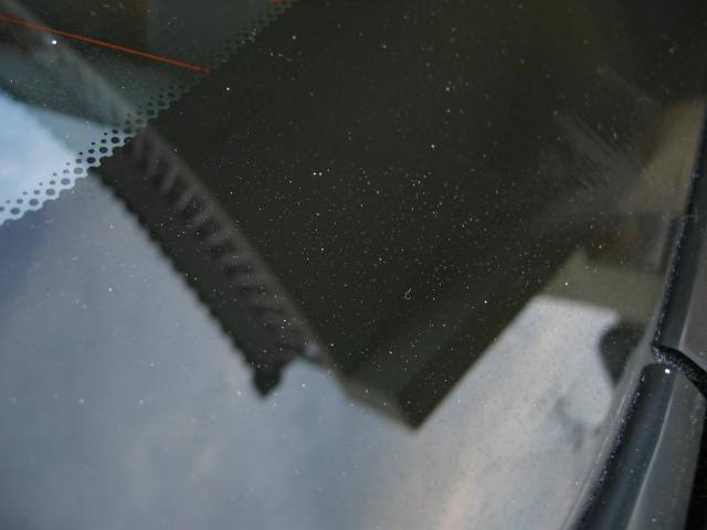

before glass corrections
lines are drawn & set before going
Here they are:-
pics 50/50 of window corrections
rear winscreen before correction pics
after

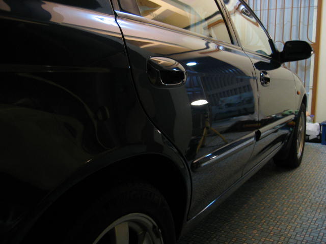

some finishing pics
ma ma mia now

pics of the roof after

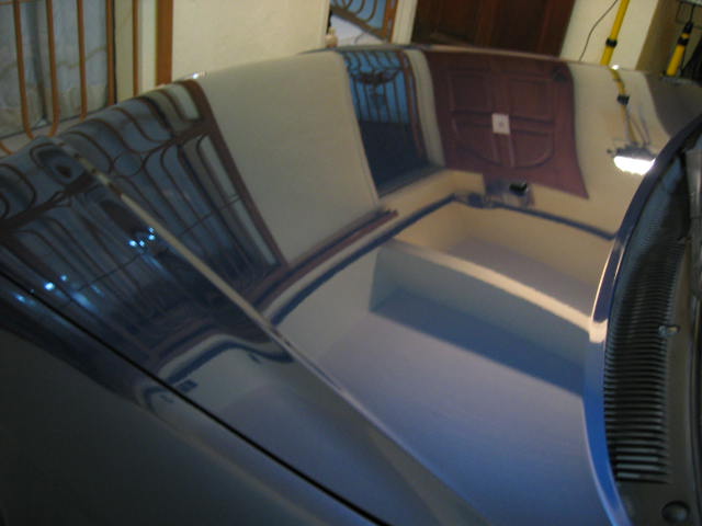

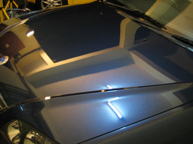

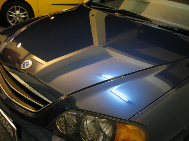

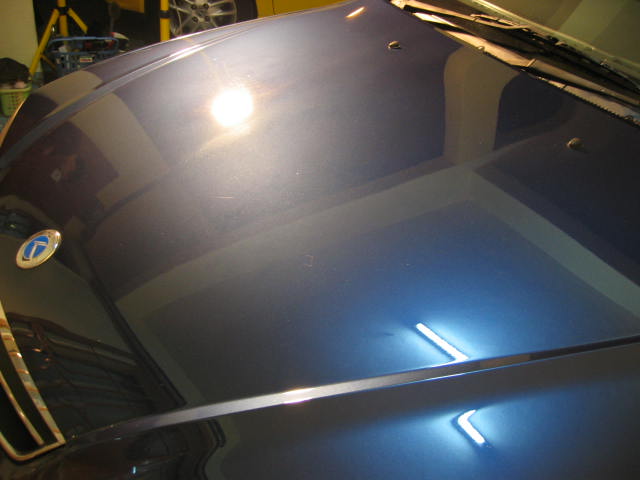

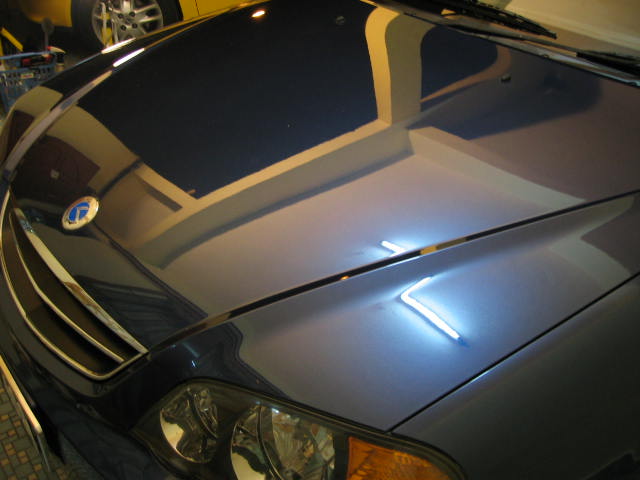

front panel
remember before
under light
ma ma mia
thanks for viewing again

Polishing -
Here they are:-
after

some finishing pics
ma ma mia now
