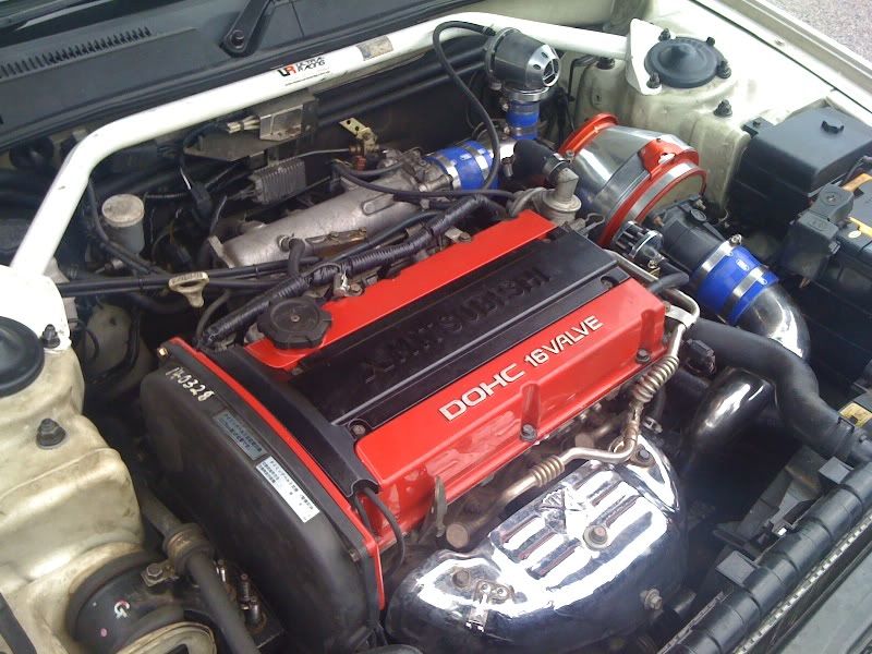

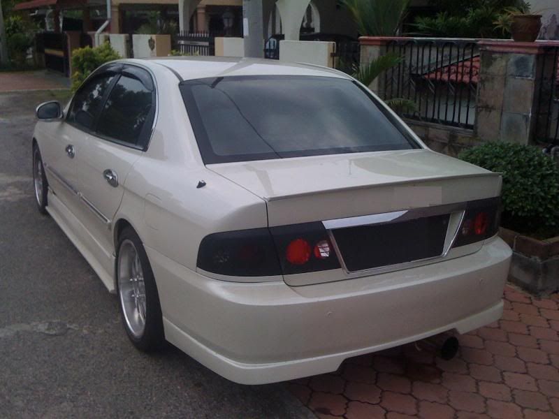

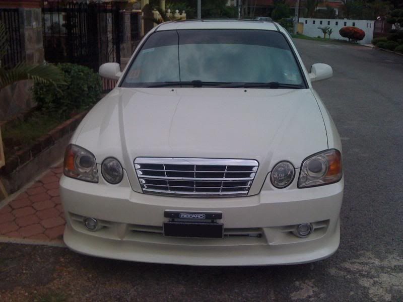

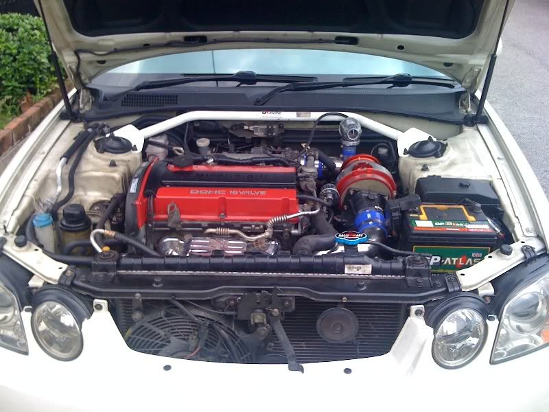

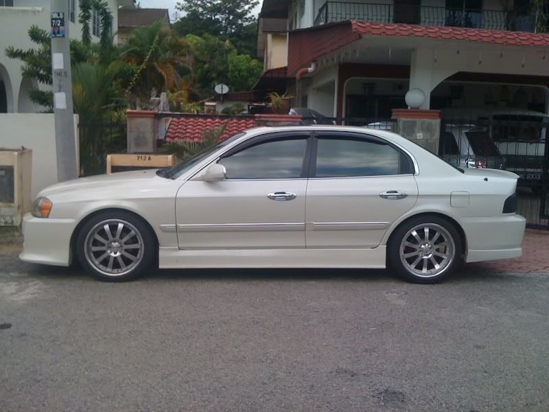

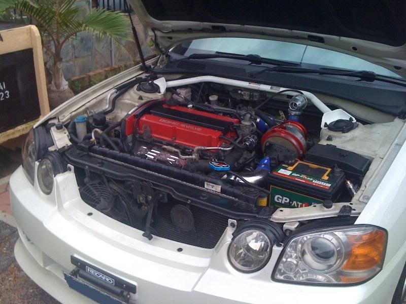

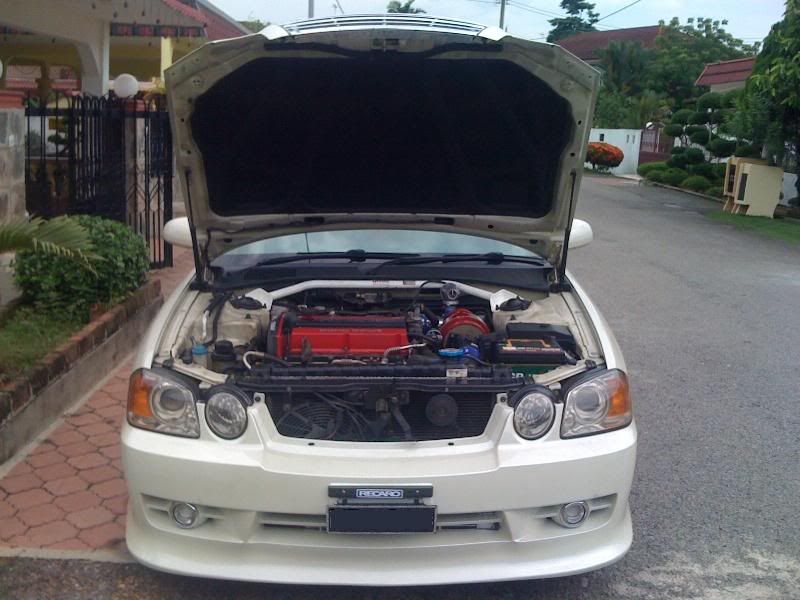

Some bros here know that my bro-in-law was working on a project. Converting his VIP style Optima to have a faster and more 'drivability' motor, 4G63T from Evo4. The project is completed but he faced a lot of challenges. I believed this could be the only 1 in Malaysia, Kia Optima Evo4.
He broke his drive shaft once and a week later, cracked his LSD. Anyway, it is done now. He told me he still has a lot to do but they are coming soon. Bucket seats, silicon pipes... bla bla bla... anyway, do enjoy the pictures!

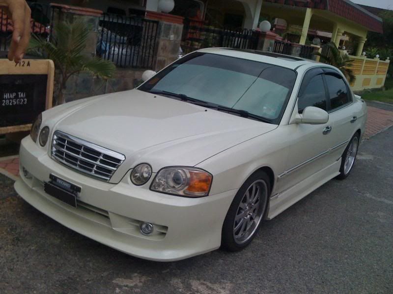

The car!
Frontal
Rear

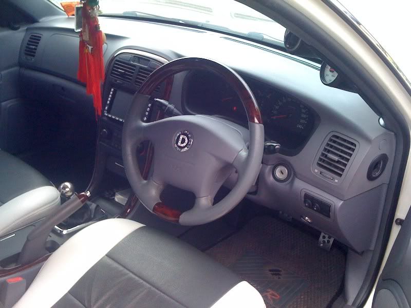

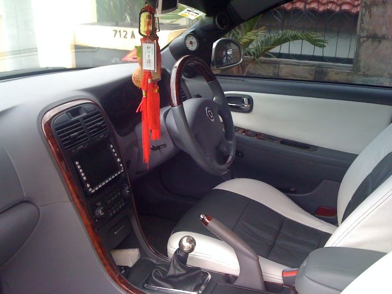

Inside

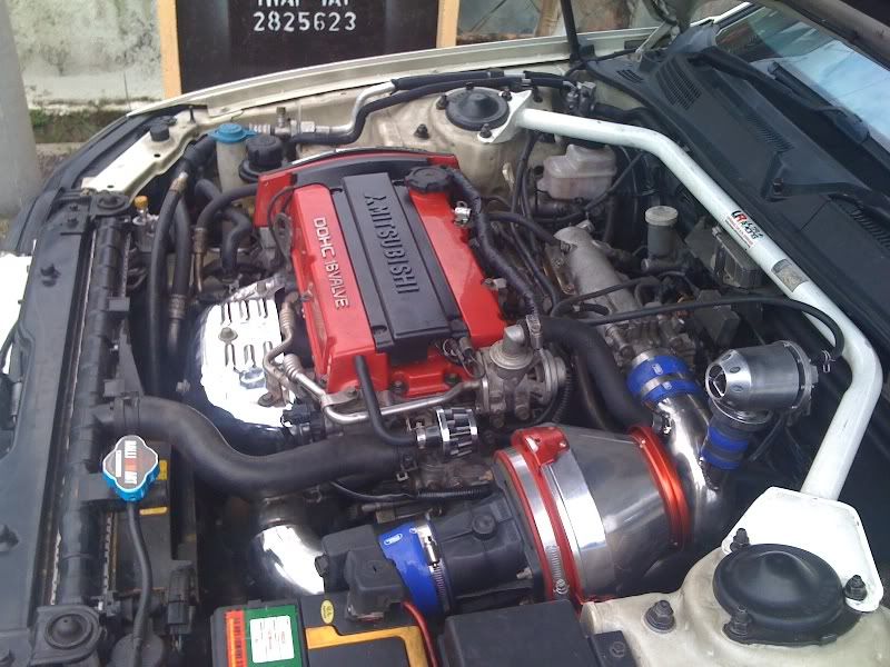

The HEART!!!!!

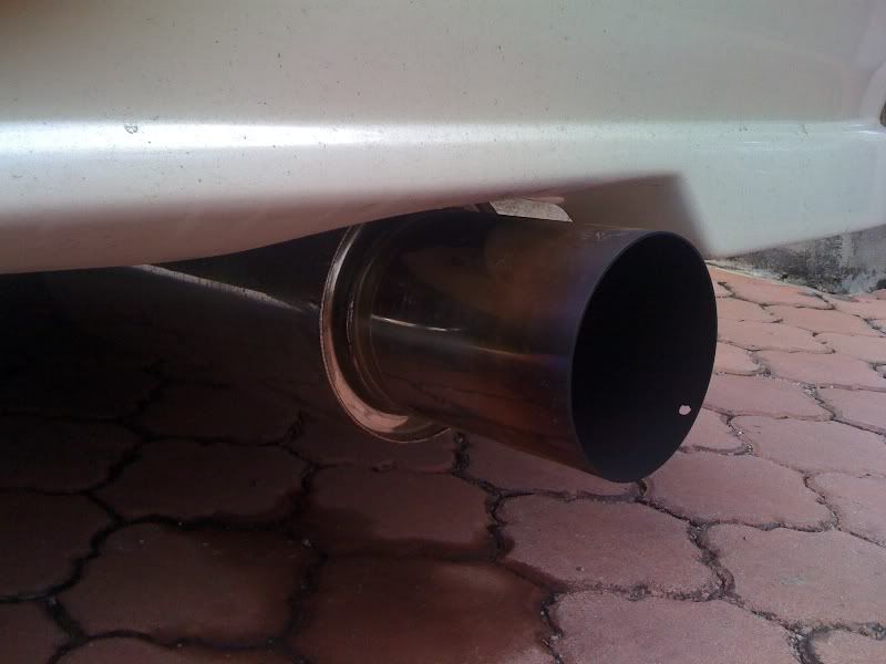

Exhaust
More to come soon.....

How come the drive shaft broken?cut and weld? AWD? nice ride there...
stutzedward
May 27, 2009
3,416
561
1,713
KL
I think he was overly excited when he got the car. After a few agressive sprints, it broke. Anyway, a new custom made drive shaft (entire set) was made and installed, it's all good now. The LSD broke because the mech did not weld properly to kill the AWD.
I've driven the car. It's very well balanced. A great job installing the engine because it is very smooth and quiet in the cabin, much like the original engine except for the exhaust note. Fast? Well, it's not brutally fast but fast enough for daily use. With 280hp in stock, it's fun to drive around town. Exhaust piping is 3" from front till the muffler.

waa..finally..well done...Malaysia boleh tuu~..hehehe..exterior n interior wise looks decent je..but when pop up d front bonet,walahh..there u go..:burnout: so bro stutzedward,when wil come out in Extreme/Hypertune mag ni??:biggrin:

Q: how bout the engine mounting? same?
...nice & clean (sleeper) ride there...
