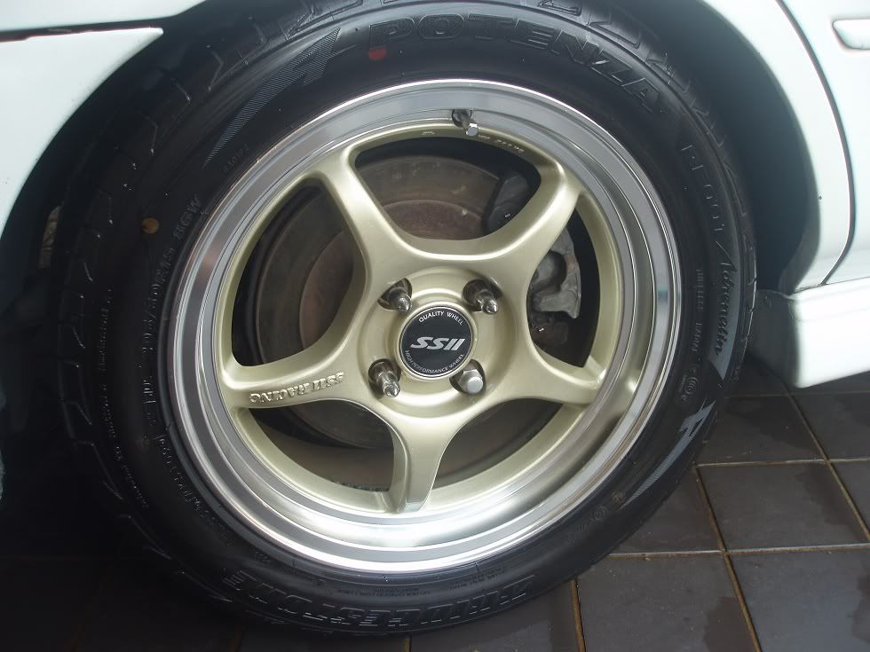

Im using a pair of twin pots from a levin HC, and the rear I have no idea whether its convert from front or what. I attach the pic for you guys, dont know useful anot.

PS - the picture is the pic of the rear disc

Q2: Are u sure u converted from front to rear? I saw from picture it is OEM AE111 rear brake system. :hmmmm:

Q2 - err i not sure where the rear is from. i dumped my car at mechs then went outstation... come back mech said use back original. maybe he meant use back "original" ae111 ... i will have to double check hahah...
