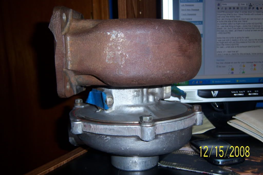

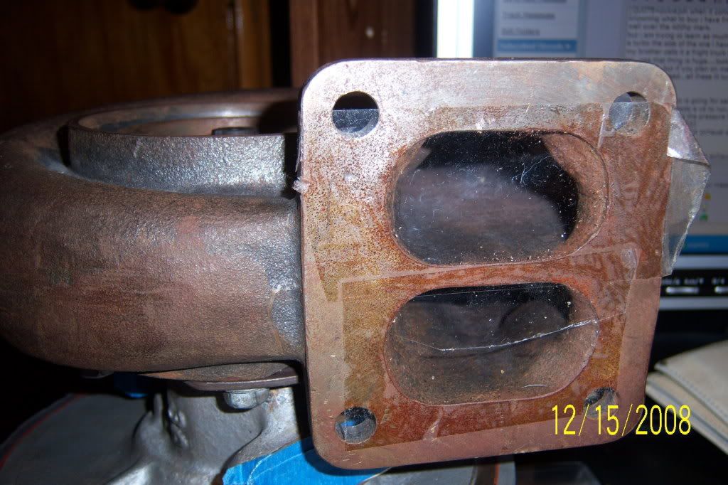

heres some pics

i think its going to be too big for ur cobalt. u can try to change the turbine housing to a smaller size. maybe T3 a/r 0.82 but i'm not sure if you can use garrett turbine housing on IHI turbo.

tell me whts the reading at the exhaust housing, there should be some numbers over there
if its too big, it wont blow ur engine, it will just be laggy n not make power, u need something thats sweet n nice. the most important thing for a big turbo like this is TUNE :)

looks like it says Q35E and on the other said it says A5
the motor is being built sleeves, rods, pistons, the whole 9 yeards

i have one of this turbo...can find ar 0.78 back housing from the lorry chopshop around segambut...if the diameter of lorry is small just lathe it to fit...anyway what is your ori ar?it look like 1.++ ar

Q35 is very huge mate.
where you located please ?
we may have a smaller used turbine housing sitting on the shelf, no promises.
As for oil, it's ok to go full flow.
Could you snap a picture of the IHI name plate, it'll tell us more about the turbo.

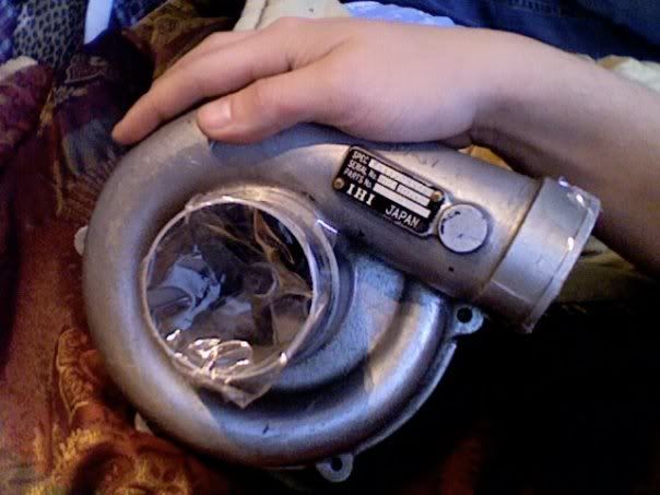

yup i will do that right now here you go.
sorry my camera wouldnt take a clear shot but here is the stuff it says:
spec:VQ41FCW37S
Serial No.: RHC7 7114303
Parts No.: blank
IHI JAPAN
and above the tag it say TAC-37
and i am located in Nova Scotia, Canada

apparently VQ41 = RHF4 = used on Daihatsu Diesel...hmm...but your name plate details are all wrong.
Prob the person who made this turbo had the "intention" to midlead others..so if you tried ordering for the same turbo...you'd get a wrong spec !
Anyway if u'd like you could look up local performance shop to help you downsize the Q35 turbine housing...way too large now to use.
