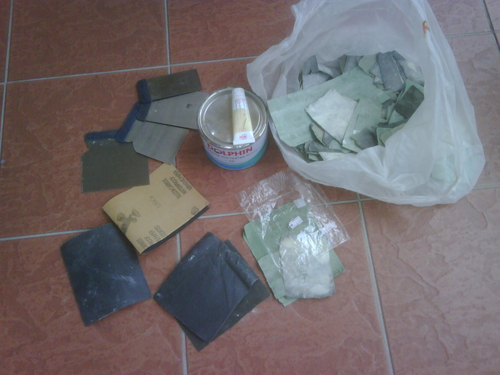

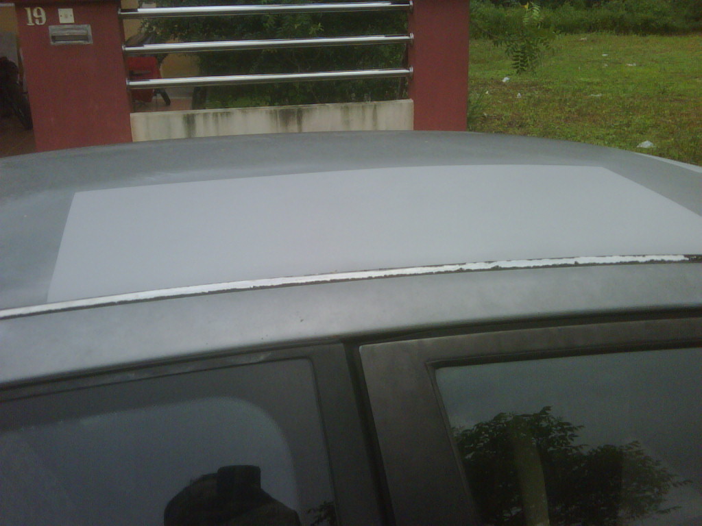

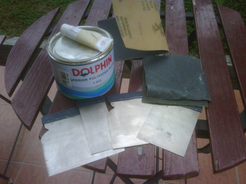

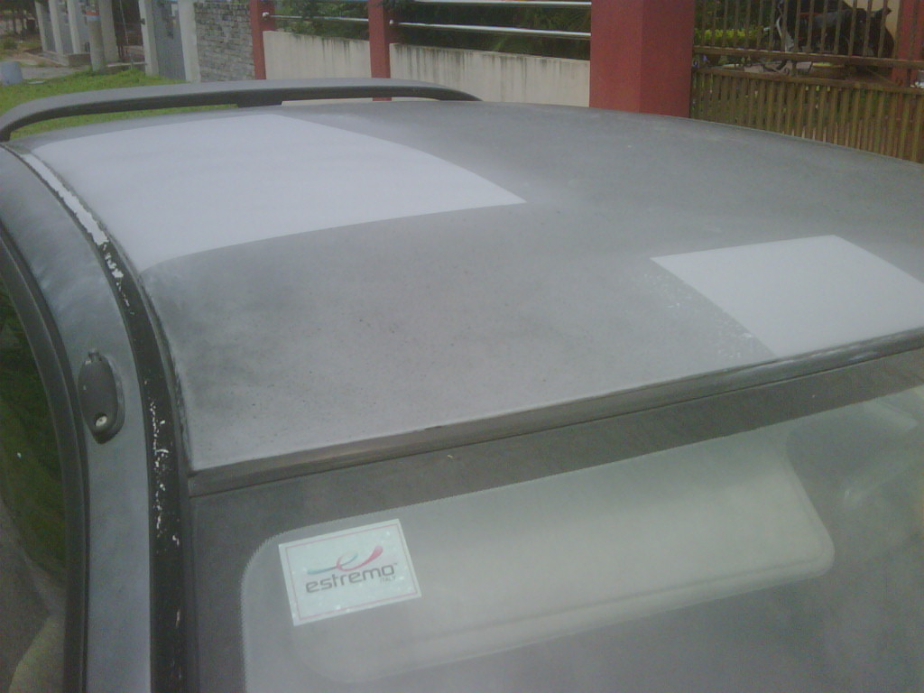

right now im doing this so called DIY roof paint job.
ive done;
1.sand paper the roof.
2.remove the rust.(outside,until hole was found)
3.remove rust(inside,scrap the glue and spray WD40,will look for hammerite when i come down to ACE in PJ)
4.fill the holes with fibre+hardener.
5.sand paper the fibre to smoothen the surface.
my Q now is,
1.what should i do next?iz it pour the nexa (N/C hard putty)?how to put it?i oredi buy the putty.
please advise.

I did mine a year ago,
1. Remove rust until see the hole
2. Remove all damn glue.
3. Apply "Hammerite Kurust" on rusty area, wait until it dry then apply again.
4. Send my car to weld the hole area, apply some Kurust on weld area.
5. Paint Kurust area with 'Hammerite Direct To Rust Metal Paint'
Both of this items and be found at ACE Hardware.
Too bad I live in Penang, I got this from EBAY.
Result until now no problem,. :)
normally u will see rust few months later if u let painter shop to repair rust.

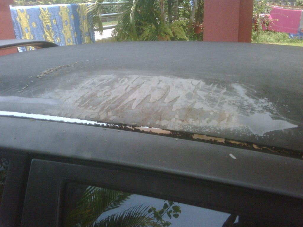

Just resprayed the roof of my Putra because of rust, cost me RM450 which also include respraying the rear bumper. I personally 'kopek' all the rust on the roof to bare metal & applied Kurust before giving it to the painter.
But I know the rust will appear again in 1/2 years time, the roof is rusting from the inside out because of the cheap/acidic glue that Proton use to glue the roof panel to the roof frame.
There is a solution - change the roof panel & scrape all the glue when changing the roof panel but this is costly & involve to much work as both front & rear windscreens have to be removed. I know somebody who did it for her Satria - cost - RM2,000/-.
Bro, for the bonnet just buy an el cheapo Taiwan bonnet for less than RM200 & have it repainted for probably another RM250.

Sifu risyia,
Thanks for advice bro. Hmm so bonnet(RM200) + paint(250). I wonder how much is the cost for painting roof alone.
Here are some photos:
I heard paint whole body cost is sometime equal to paint certain part (Eg: bonnet and roof). Is it true? and how long would it take to complete painting? Just want to double confirm.
