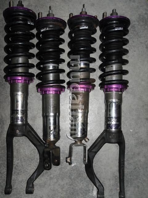

Hi guys...i just bought a HKS Hipermax 2 (second hand) to use at my Honda SO4 and i feel it very bouncy. my question is...
  1. The bouncy happens at the rear shock abs. Is it because the gas is out or the oil seal has already leak?can it be fix?cause i think I'm just running totally on the spring right now...

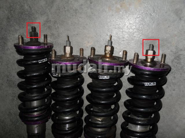

  • How to adjust the condition of soft/hard??i cannot hear any clicking sound at the adjuster at the rear shock abs. and at front have nothing (red box).
Can anyone please help me especially they that had used this or still using it..cause i already spend quite a lot of money buying this shock abs...wanna make sure it worth...thanks.

bro as i know HKS hipermax 2 can adjust back and front.
do you have the tools?
Glory_manunited
Jul 16, 2011
54
2
508
Don't have....where to get it....do we really need this thing to adjust the soft hard??or is there any other way??

should be the same as the ones available in the standard set of allen keys bro.

cant move clockwise or anti clockwise? front and back absorber also same?
maybe using wrong size key?
assuming u r using the right key, i think maybe the adjuster knob jam already and need to send for servicing..ive experience this beofre but not on hks..

Rear is ok..the problem is for the front only....i am really sure ive tried many sizes...and really sure cant feel anything....
I already made some research in the internet....seems like the key is quite different compare to allen wrench....definitely....try to buy it online...but got problems with my credit cards....

aiks, above u said rear cant and front cant. ok..maybe try go to halfcut shops and see if they have the tool.. or call like those performance shops in sunway and check out

Rear just discover that the abs is kong already...need to refill back the gas...just running on spring right now...very dizzy....hahahaha...
I already call kakimoto..they will try to find the said tools....very hard to find...if anyone here have one maybe can sell it to me... :biggrin:

like i told u, my HKS has a different top from yours....and using size 3 allen key, can easily adjust the damping.....if yours can't, so true laa like i told you also, your HKS belong at the bottom of selat melaka....kekekeke.....

Demmit Udeng....hahahaha...mine is better then yours la....like i said last night, mine use special tools..not all allen wrench can go in...very "secure"...hahahaha...
