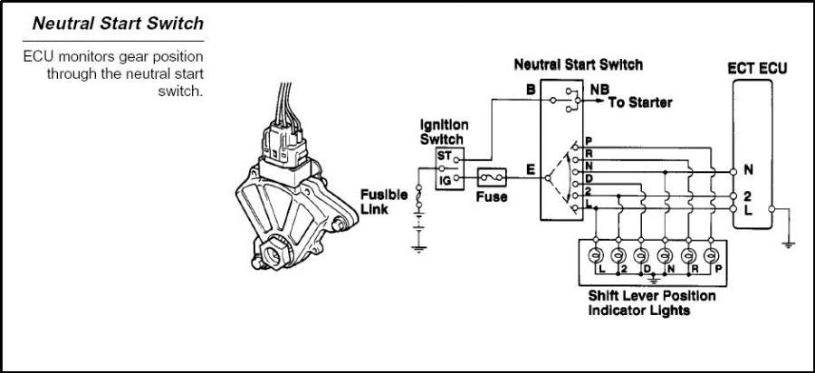

I'll try it.... make the engine hot..... then i'll find the NPS switch... can I remove this switch?
If your Neutral Start Switch has problem, your starter won't be able to crank at all as the Neutral Start Switch will cut off the current supply to the starter. If your starter still can crank, than the culprit is not the Nutral Start Switch.
