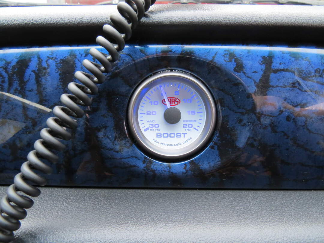

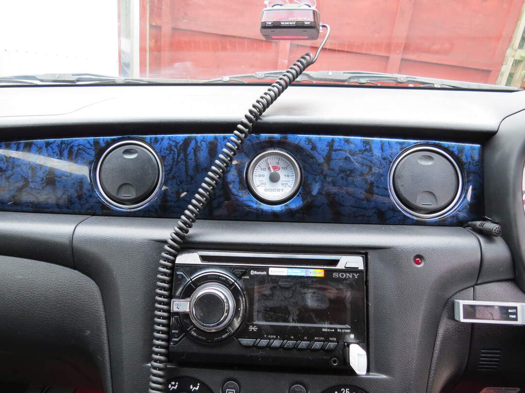

Thanks for the info. Its a RHD so I'll check out next to the throttle cable when I get a chance. Anyone had any experience fitting the boost gauge where the factory clock is?

The boost gauge I brought is a perfect fit in place of the analogue clock on the dash. Just waiting for the glue to dry overnight. Bonus there is power and an illumination wire right their too.

I wasn't too keen on removing it either but it was a nice spot and I decided the stereo has a clock instead.

Haven't decided on a colour yet, the gauge will display in blue, green, white or red but the button is on the back. Thinking red to match the dash display.
