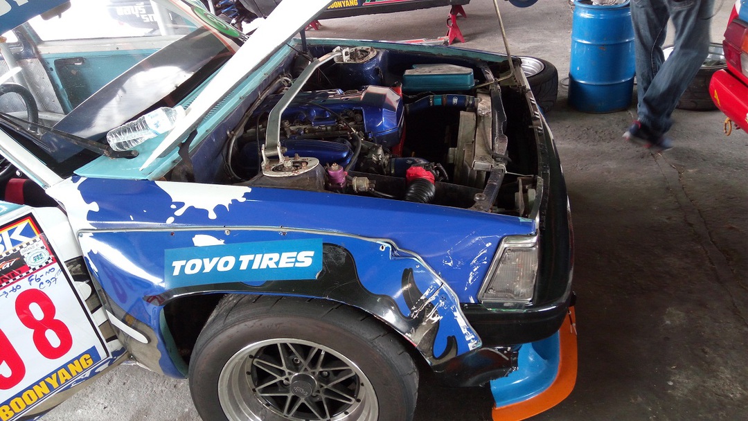

have seen JZ 2 turbo engine in a KE70 in Thailand, that must be one of the most popular engine's for drifting? They are cheap here in Thailand but mostly come with Automatic gearboxes, so you would need a suitable manual box.
This KE70 has a BEAMS engine that looks like a neat install and probably better weight distribution, can find with a 6 speed manual from IS200
If you don't mind a Nissan engine an SR20DET would give good power and be a good fit, they are fairly cheap (at least here in Thailand) and can find with a manual gearbox.
hope you post some project pictures whatever you decide. An old non-runner KE70 I can find really cheap here in Thailand and I have in the back of my mind to get one to do a swap and turn into a 'track pig' for fun if I could find somewhere to store it and work on it here.
