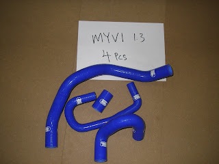

The manual specifies an 8yr change interval for emission hoses. Does it refer to just the pcv/breather hoses or are there others? When I went to the shop to get replacement parts, the guy at the counter suggested a replacement hose which I didn't recognize - quite short ~2-3in, ~0.75in diameter.
And just to be sure, the the pcv/breather hoses are connected to the 10 o'clock and 3 o'clock positions on the throttle body right?

Should be the bypass hose near the thermostat and the other should be to the inlet manifold for warm up

You're right, those were the bypass hoses. The shorter one connects the engine to the bypass valve which also connects to the upper hose.
