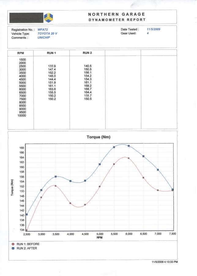

the stock BT 4-2-1 extractor having worst torque in low and mid rpm.
refer to my dyno torque graph
i heard that this custom made extractor can help to distribute the torque more equally.

How come your torque curve seems abit weird? I thought it should be quite flat for 20v? I dont think you can fit such extractor under your ae101? You will be hitting on bumps? I think in the north there is one called Chean Exhaust that can help you

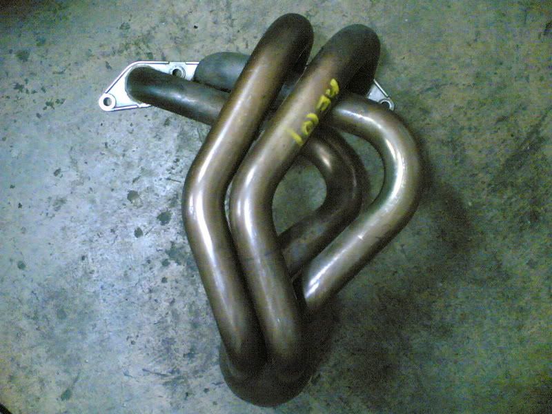

bro jacky...
i guess u are driving ae101/111 corolla with 4age 20v..
but the picture show is tarik belakang 20V woh. i dun think can match ur car on this custom...
btw.. if ur budget allows... i advised u can go for aftermarket extractor from Japan(used item )
like HKS, FGK, RSR, or etc..4-2-1 or 4-1
i guess result, quality and finishing shud be better than the 1 in picture...

How come your Run 2 so much difference? Extrator?
i added piggyback unichipQ.

Well...just my 2 cents on the CO2 sensor la...errr...i think standard aftermarket headers like RS-R or Apex'i has their reason for the right calcutaion for the sensors to be install at that default place...by moving the sensor too much to the front up....don't think is a good idea...
From the link you show us....that is actually a setup for a RWD ...so i also think that the custom setup is not quite suitable for FWD 4AGE.... if u do notice...both RWD & FWD header length calculation are very different...
Correct me if i'm wrong... just my dua cent... don't shoot me... i'm using RS-R 4-2-1 cheerss...

Got difference in drive feel? The curve look very nice. If you got visit ah Loy, pls stack my graph vs yours and tell me the difference (stock ECU running Cusco Extractor)

below are my car setup during the dyno.
setup:
1) stock BT Engine
2) Using Ron95 petrol
3) stock plug cable
4) Open port Apexi filter
5) Sars fuel regulator
6) Custom piping 2.2" with lousy S-flow muffler
7) iridium plug
8) Idemitsu 10w/40 already run 2000 km since conversion
9) Piggyback Unichip-Q
im doubt will my torque become more flat (better in low,mid and high rpm) if i change to aftermarket 4-2-1 extractor and straight flow muffler ?

regarding japan extractor mandrel bend as u said...
the item below is FGK- 4-2-1
or
HKS racing header
or cusco 4-1
hope this will help u..
