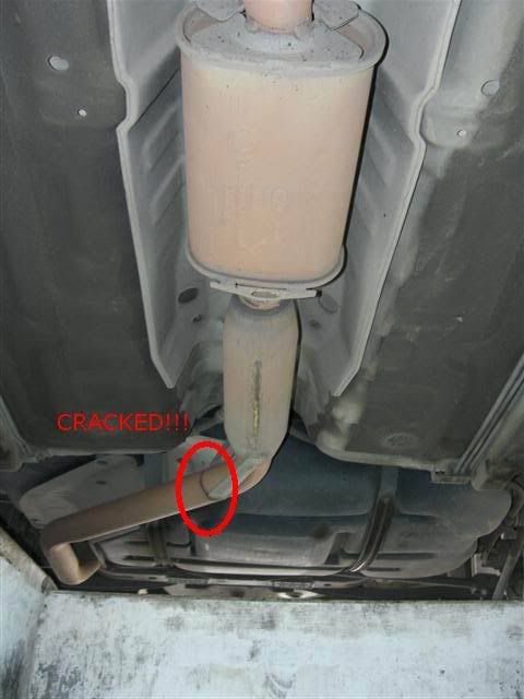

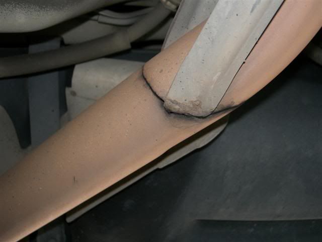

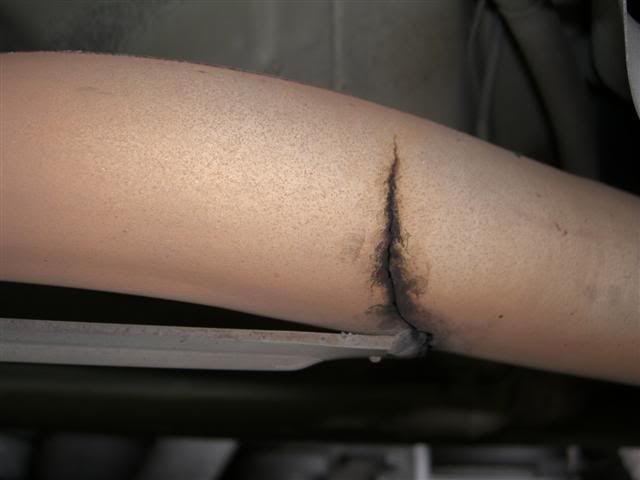

I heard the sound of my stock exhaust automatically converting into the sound of performance exhaust.. So I decided to jack the car up and see what happens.. Photos here...
General view (cracked)
Bottom view (cracked)
Side view (cracked)

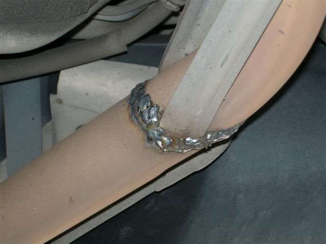

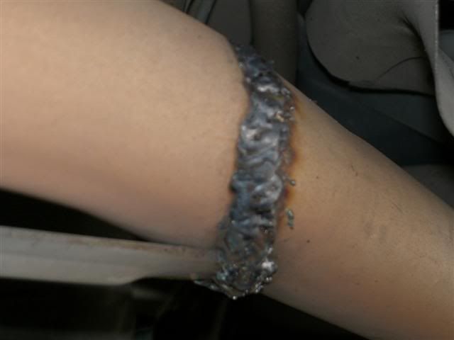

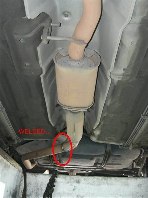

General view (welded)
Bottom view (welded)
Side view (welded)
Luckily I jack up the car and see.. Else my muffler will drop off at north south highway...

Cracks normally does not happen overnight. Should already been there for sometime except probably now the gap becomes bigger and audiable. You might want to consider changing out your Exhaust Hanger, It look worn and loose.........that might be your root causes on the exhaust crack.

Thanks my lord! I am planning to change the exhaust hanger after I get my new extractor ceramic coated..

Sim, your welding won't last long, it's too thin, even maybe at high temperature, you can feel exhaust air leakage. dun rev too much. :biggrin:

The stupid fella do welding in-situ.. He didn't even take down the exhaust and weld.. And he didn't wear protective goggle.. so he weld like sh*t.. The worst thing is.. He doesn't know that he is working directly under the petrol tank..
Anyway, I plan to visit Robert next month to look for muffler.. By that time then I take it down and do re-welding.. Anyone wanna go with me?
