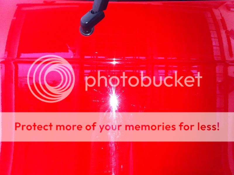

Hi SIFUs at ZerotoHundred, I am new to machine polishing and recently I had try out the Meguairs D300 compound with their microfiber finishing disk and got the result below. The result is good but I think it could been better as I feel like there is light haze from the compound.
Before:
After:
From the picture I hope all the experience Sifus can help me to confirm whether this is compound haze or not?
If yes, then I am thinking to follow up with a step of Polish, will this step remove the haze as in the picture?

Yup...looks like compound haze to me. Should look better after another step with a lighter polish. Btw, what machine did you use the D300 with?
Anyway, do you already have those products that you mentioned (OHP, Megs UP & Opti Seal)? If you plan to use Opti Seal, better go for the same brand as they should already had tested them for compatibility. Regardless, a wipedown with IPA or panel wipe or a wash with an all purpose cleaner (remember to rinse!) would help to remove any leftover polishing oil from the surface and does help with the bonding of a sealant (better performance).

After looking at my PC screen I seems to notice that
Not only there is compound haze but rather there is not enough cut
What pad combo you use? Speed ? Passes? And how often you Clean your pad?

Hi Sifu KC, I must admit my technique/skills is noob as this is my first time handle the DA110v2. I remember it is 2-3 passes with moderate pressure speed 4 then 1-2passes with speed 3. Using the microfiber cutting disk. I need to improve my skills.. :p
Everybody must starts from some where
I reckon u Do not cut enough
