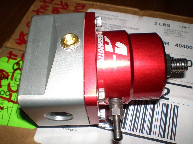

buy it online n ask them to ship it
ehem , nah proof to u
hehe wan :P thanks for the photo

wah!! thanks jinkl! very nice FR! how much it cost?Cun wei!
I dunno what im gonna do with my kaput SARD FR, mine was ori,bought it at kakimoto 3 years back, maybe goin to install it to my wife 660 viva(already installed NEO on it, last time go dyno with all std spec including the tayar besi, kena gelak wei!) ahahhaa!!
