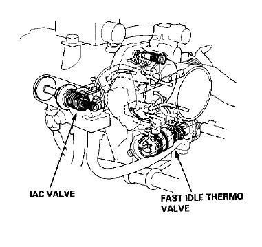

Honestly that doesn't look too bad in the video. You are playing around with the throttle right? raising it to 2K rpm and then letting off. Try looking at the FITV as well. No CELS right? Diaphram on the FITV normally gets stuck if your radiator water is all rusty. Anyway, do you have any warm up issues? erratic idling during warm ups?
FITV is the located under the throttle body as per the picture.

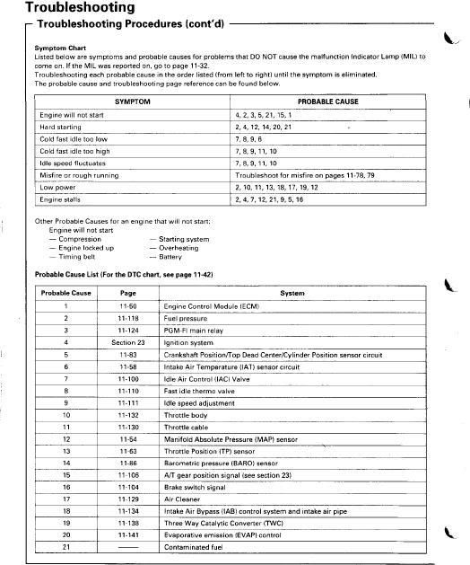

Here's a troubleshooting guide.
Just a quick check on the FITV. before the throttle body flapper. There's a small hole there which is operated by the FITV. You'll feel a slight vaccuum there on the small hole. Try blocking it with your finger and ask someone to play around with the throttle and see if the same problem persists.
