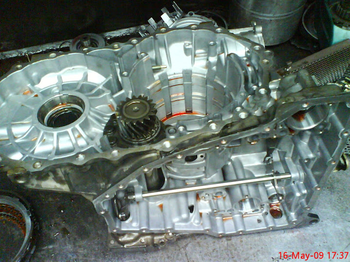

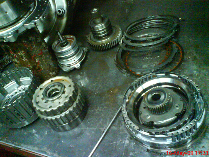

What i did was changing only the clutch plates....Using the 3.0L spare kits.
In Total i spend like 3.3k including the gear oil, parts and workmanship.
Did it in Setapak.
Works like original...Happy now.
dream.tent,
You got the repair kit from the setapak workshop or direct from Spare parts shop?
dream.tent,
The shop is a gearbox specialist and fix all range of Japanese cars and Contis too.
I left the car with them for 3 days.
They replace all the internal clutch plates and replace with new ones. (Came in Nissan Ori Package)
---------- Post added at 11:40 PM ---------- Previous post was at 11:09 PM ----------
Some photo...
i actually had an option to either repair the old one or to replace with recond one, but i chose the latter, cos repair costs about 50% more, which is about the same price as posted by dream.tent.
However, now looking at the photos posted by dream.tent, i kinda regretted... the gbox repair looked quite professionally done...
